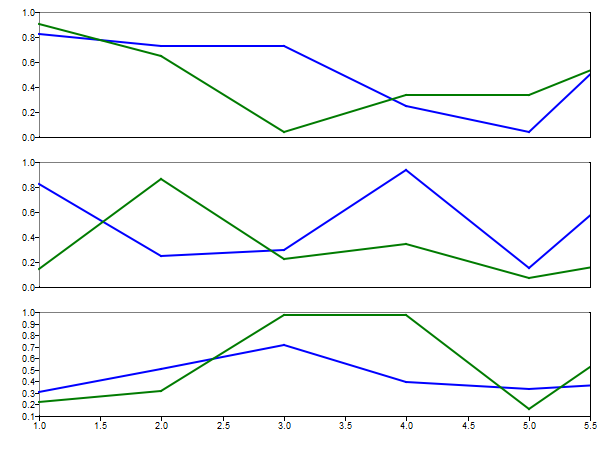

Link x axes example: Figure 1. Link x axes
figure;
ax1 = subplot(3, 1, 1);
plot(rand(10,2));
ax2 = subplot(3, 1, 2);
plot(rand(10,2));
ax3 = subplot(3, 1, 3);
plot(rand(10,2));
linkaxes([ax1, ax2, ax3], 'x');
set(ax1,'xvisible','off')
set(ax2,'xvisible','off')
xlim([1 5.5]);

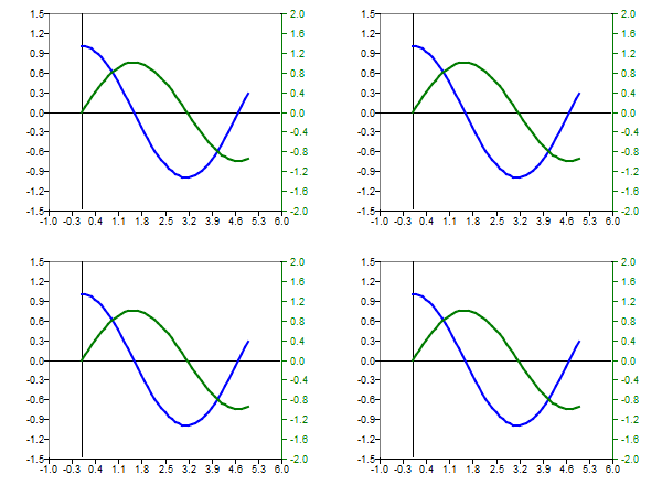

Link all axes example: Figure 3. Link all axes
x = 0:0.1:5;
y = cos(x);
y1 = sin(x);
figure;
ax1 = subplot(2, 2, 1);
plot(x, y);
axSec1 = addaxis(x, y1);
ax2 = subplot(2, 2, 2);
plot(x, y);
axSec2 = addaxis(x, y1);
ax3 = subplot(2, 2, 3);
plot(x, y);
axSec3 = addaxis(x, y1);
ax4 = subplot(2, 2, 4);
plot(x, y);
axSec4 = addaxis(x, y1);
linkaxes([ax1, ax2, ax3, ax4]);
linkaxes([axSec1(2), axSec2(2), axSec3(2), axSec4(2)], 'y');
xlim([-1 6]);
ylim([-1.5 1.5]);
ylim(axSec1(2), [-2 2]);

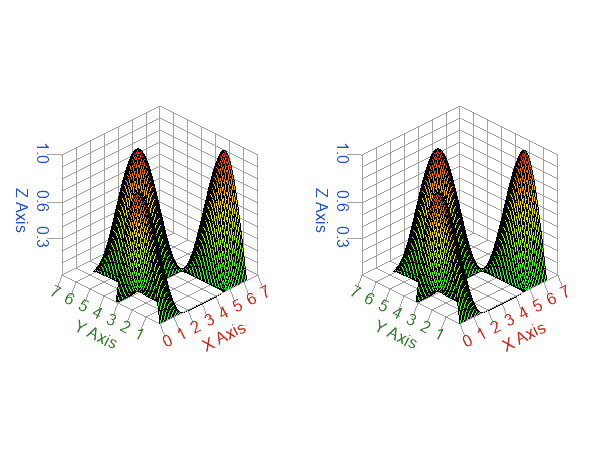

Link 3d plot axes example: Figure 4. Link 3d plot axes
x=[0:0.1:2*pi];
y=x;
z=sin(x')*cos(y);
figure;
ax1 = subplot(1,2,1);
surf(x, y, z);
ax2 = subplot(1,2,2);
surf(x, y, z);
linkaxes([ax1, ax2], 'z');
zlim([0 1]);
