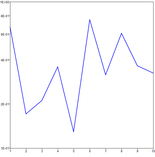

Example
Simple semilogy example.
semilogy(rand(1, 10));
