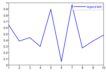

Example
Simple legend
example.Figure 1. Legend Example 1
clf;
plot(rand(1, 10));
legend('on');

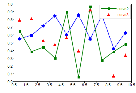

legend('legend text');Add legends for selected
curves.Figure 2. Legend Example 2
clf;
hold on;
h1 = plot(rand(10,1),'--o');
h2 = plot(rand(10,1),'-s');
h3 = plot(rand(10,1),'r^');
legend([h2,h3],{'curve2','curve3'});

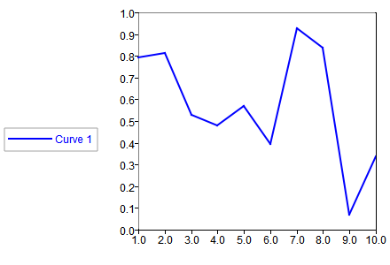

Set the location of the
legend.Figure 3. Location string example
clf;
plot(rand(1, 10));
legend('location','westoutside');

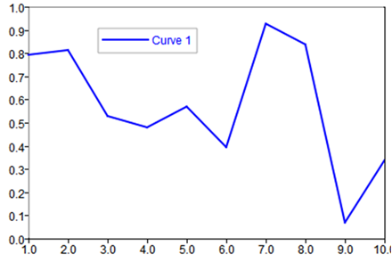

Set legend location
coordinates.Figure 4. Location coordinates example
clf;
plot(rand(1, 10));
legend('location',[0.2 0.1]);

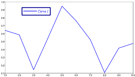

Example setting legend properties.Figure 5. Legend Properties
clf;
plot(rand(1, 10));
h = legend('location',[0.2 0.1]);
set(h,'fontangle','italic');
set(h,'fontname','Times New Roman');
set(h,'borderwidth',3);
set(h,'bordercolor',[0 0 150]);
