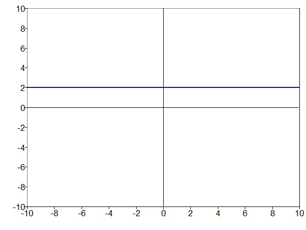

Simple yline example: Figure 1. Horizontal line at y = 2
clf;
h = yline(2);

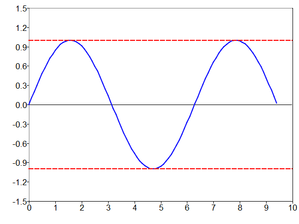

Create horizontal lines and set properties example: Figure 2. Create 2 lines and set properties
clf;
x=[0:0.1:3*pi];
plot(x, sin(x));
h = yline([-1;1],'color','r','linestyle','--');
ylim([-1.5 1.5])
