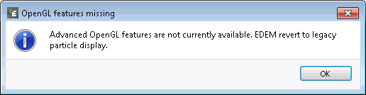

- If you select Legacy Particle Display, EDEM does not use the processing machines graphics card effectively to display the particles.
- If you do not select Legacy Particle Display when
using Remote Desktop, the following message is displayed:
To use the Advanced OpenGL features on Remote Desktop, do the following:
