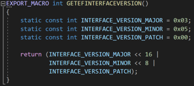

To update the API version, starting from the source code of a functioning
plug-in, ensure that the plug-in is updated to be using at least version 3.5 of
the relevant (either contact model or particle body force) API.
This is done by editing the values within the
GETEFINTERVACEVERSION() or
GETCMINTERVACEVERSION() macros as follows:
Note: This is a mandatory step to access
pluginParameterManagerand various functions that allow
you to create a custom dialog box for your plug-in.

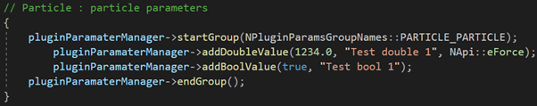

To define parameters in setApiParametersTemplate() for the
Particle-Particle, Particle-Geometry, and Particle Body Force groups, start
the group before defining your parameters and close it as follows:
Define a Double called ‘Test double 1’ and a Boolean called ‘Test
bool 1’ with the default values '1234.0 ' and 'true'
respectively.

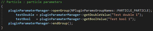

To retrieve these values in the starting() function, use
openGroup(), getDoubleValue(), and
getBoolValue().
You are assigning the retrieved Double and Boolean values here to
member variables that you can use in your plug-in as required.

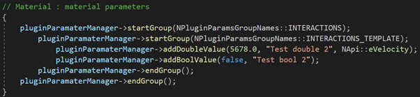

To define parameters for material interactions, follow the same steps but
first add an additional group to define a template that all the other
interactions are based on.
To implement setApiParametersTemplate(), perform the
following steps:

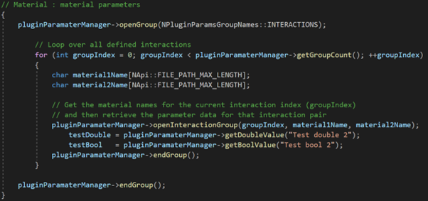

To retrieve the data, perform an additional step as the material
interactions need to be looped over for all the defined interactions that
are unknown at the time of compiling the plug-in:
