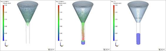

Untapped Bulk Density Test
Tapped Bulk Density Test

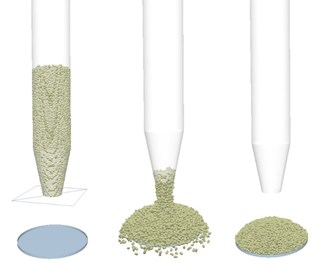

Static Angle of Repose Test
