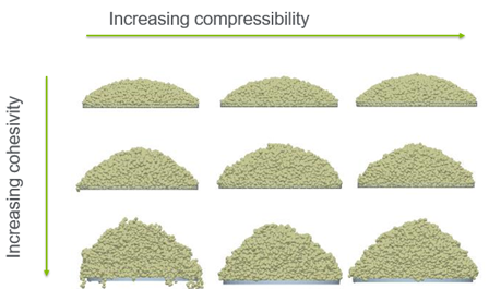

| Non-compressible | Mid-compressible | Highly-compressible | |
| Non-cohesive | Case 1 | Case 2 | Case 3 |
| Mid-cohesive | Case 4 | Case 5 | Case 6 |
| Highly-cohesive | Case 7 | Case 8 | Case 9 |

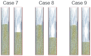

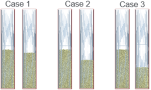

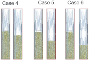

| Case | Sample height before compression (mm) | Sample height after compression (mm) | Amount of compression (%) | Compression Ratio | Carr Index (%) | Hausner Ratio | Flow Character |
| 1 | 91 | 83 | 0.09 | 1.1 | 7.5 | 1.08 | Excellent |
| 2 | 91 | 66 | 0.28 | 1.4 | 5.59 | 1.06 | Excellent |
| 3 | 91 | 49 | 0.47 | 1.9 | 4.92 | 1.05 | Excellent |
| 4 | 102 | 87 | 0.15 | 1.2 | 8.34 | 1.09 | Excellent |
| 5 | 100 | 67 | 0.33 | 1.5 | 6.49 | 1.07 | Excellent |
| 6 | 101 | 50 | 0.5 | 2 | 5.69 | 1.06 | Excellent |
| 7 | 120 | 88 | 0.27 | 1.4 | 13.32 | 1.15 | Good |
| 8 | 118 | 67 | 0.43 | 1.8 | 16.71 | 1.2 | Fair |
| 9 | 116 | 49 | 0.58 | 2.4 | 16.48 | 1.19 | Fair |

Research has shown that values of Carr Index below 15% indicate very good flow character but values above 25% indicate poor flow. Also, Hausner ratio values of around 1.00–1.25 indicate free-flowing powder, values between 1.26–1.45 indicate poor flow, and above 1.46 are related to extremely poor flow (Carr (1965), Wells (1988), Marshall (1986). The EDEM tapped density results indicate that the overall flow character of the materials is varied between excellent to fair however, the angle of repose measurements indicates that cases 4-6 have passable flow ability and cases 7-9 have very poor flow ability.
Compressibility test results are displayed as follows:
