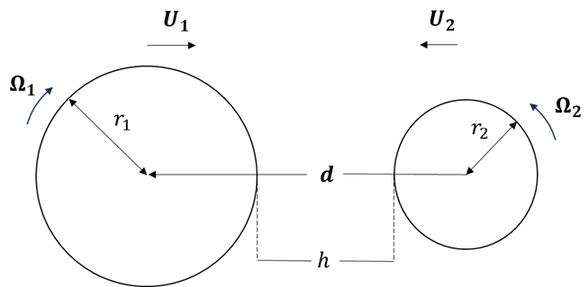

Figure 1. Schematic for two particles of radius r_1 and r_2, with linear velocities U_1 and U_2, rotating at Ω_1 and Ω_2, with center-center distance d, a distance h apart, approaching each other.

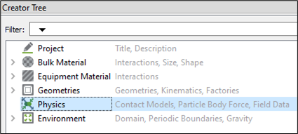

  1. In the Creator Tree, select Physics.

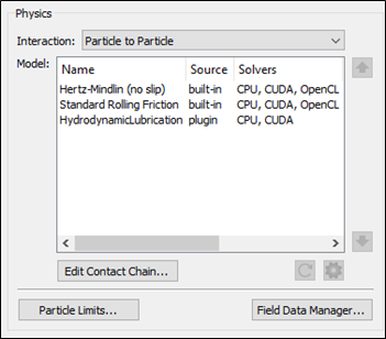

  2. Select Particle to Particle and/or Particle to Geometry from the Interaction dropdown list.
  3. Click Edit Contact Chain at the lower section of the Physics panel.

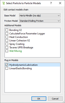

  4. Under Plug-in Models, select the HydrodynamicLubrication checkbox.
  5. Click OK.

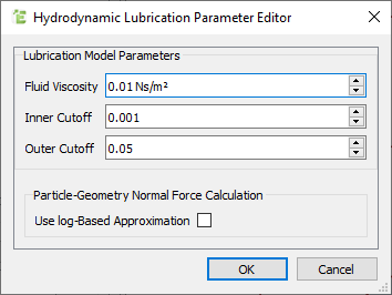

  6. Select the plug-in and click the icon in the lower-right section of the Physics panel to configure it.
  7. In the Hydrodynamic Lubrication Model Parameter Editor dialog box, specify values for Fluid Viscosity, Inner Cutoff, and Outer Cutoff.
    The Inner and Outer Cutoff values correspond to the non-dimensional values (by particle radius) between which the additional forces and torques are calculated. (The inner cutoff value should be adjusted according to the surface roughness of the material being modeled. (For more information about specifying cutoff values, see Cabiscol et al. (2021)).
    Note: Because one of the assumptions for the theory is that the particles are fully saturated with fluid, these values are applied to all particles in the simulation, rather than by type or interaction. As noted by Cabiscol et al, due to the omission of long-range fluid effects in the model, using the real fluid viscosity may not yield the same behavior as in the real-world. It has the same units and plays the same role as the real fluid viscosity, but it is recommended to perform a calibration on the fluid viscosity (as well as inner and outer cutoff values) to obtain the correct material behavior.
  8. Select the additional checkbox for the Particle-Geometry contact model to allow selecting the Goddardlog implementation for normal force.
    The most recommended default implementation is that of Goddardsum. You can select Goddardlog only if a simulation is already using the Hydrodynamic Lubrication model from EDEM v 2023.1, which only had the Goddardlog implementation, and to ensure consistency.
  9. After specifying the values, click OK.
