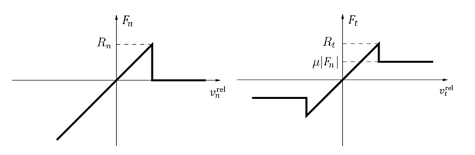

The failure criteria for the bonds can be defined as follows:
F n   ≤   R n           ( t e n s i o n     o n l y )   F t   ≤   R t MathType@MTEF@5@5@+= feaahyart1ev3aaatCvAUfeBSjuyZL2yd9gzLbvyNv2CaerbuLwBLn hiov2DGi1BTfMBaeXatLxBI9gBaerbd9wDYLwzYbItLDharqqtubsr 4rNCHbGeaGqiVu0Je9sqqrpepC0xbbL8F4rqqrFfpeea0xe9Lq=Jc9 vqaqpepm0xbba9pwe9Q8fs0=yqaqpepae9pg0FirpepeKkFr0xfr=x fr=xb9adbaqaaeGaciGaaiaabeqaamaabaabaaGceaqabeaacaWGgb WaaSbaaSqaaiaad6gaaeqaaOGaaGPaVlabgsMiJkaaykW7caWGsbWa aSbaaSqaaiaad6gacaaMc8oabeaakiaaykW7caaMc8UaaGPaVlaayk W7caGGOaGaamiDaiaadwgacaWGUbGaam4CaiaadMgacaWGVbGaamOB aiaaykW7caaMc8Uaam4Baiaad6gacaWGSbGaamyEaiaacMcaaeaaca aMc8UaamOramaaBaaaleaacaWG0baabeaakiaaykW7cqGHKjYOcaaM c8UaamOuamaaBaaaleaacaWG0baabeaaaaaa@5FA6@
Where Rn and Rt are the normal and Shear strengths (defined by the user). The bond will break under one of the following conditions:
  • The bond is under tension and the magnitude of the normal component of the contact force exceeds the defined normal strength.
  • The bond is under either tension or compression and the magnitude of the tangential component of the contact force exceeds the defined shear strength.
When under compression, bonds cannot break because of an excessive normal contact force. This is what gives the model its elastic behavior.

The model yields the following force-displacement behavior:

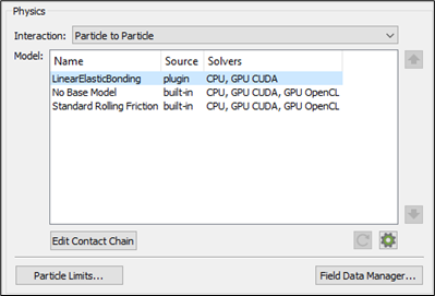

Using the LEBM
To use the Linear Elastic Bonding Model:
  1. Add the model to the Physics of a given EDEM simulation.
  2. In the Creator Tree, select Physics.
  3. Select Particle to Particle and/or Particle to Geometry from the Interaction dropdown list.

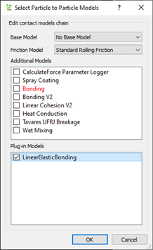

  4. Click Edit Contact Chain at the lower section of the Physics panel.
  5. Select No Base Model from the Base Model dropdown list.
  6. Under Plug-in Models, select the LinearElasticBonding checkbox.
  7. Click OK.
    The plug-in is displayed in the Model panel.

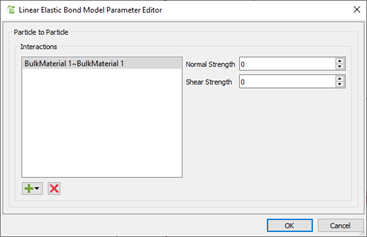

  8. Select the plug-in and click the icon in the lower-right section of the Physics panel to configure it.
  9. In the Linear Elastic Bond Model Parameter Editor dialog box, click the icon to view a list of all possible interactions for Particle-Particle or Particle-Geometry contacts.
    Note: The icon will be enabled as long as you have materials defined in your simulation.
  10. Select the interaction for which you would like to set up bonds.
    The dialog box displays two parameters on the right-hand side.
  11. Specify values for Normal Strength and Shear Strength of the formed bonds. For more information about how these parameters determine the model behaviour, see Calculating the Force with Inactive bonds.
  12. Click OK after entering the values for the interaction and repeat the same steps for other interactions for which you would like to set up bonds.
