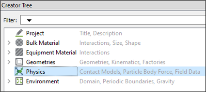

  1. Add the model to the Physics of a given EDEM simulation.
  2. In the Creator Tree, select Physics.

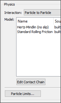

  3. Select Particle to Particle (mandatory) and/or Particle to Geometry (optional) and/or Particle Body Force (optional) from the Interaction dropdown list.
  4. Click Edit Contact Chain at the lower section of the Physics panel.
  5. Under Plug-in Models, select the LiquidBridgeAndExchange checkbox.
  6. Select the plug-in and click the icon in the lower-right section of the Physics panel to configure it.
