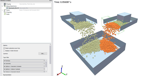

You can retain selections for any particle passing through the selection group so
that they remain selected once they have exited the Selection Group. If you use Manual
Selection, the selected particles or Geometries remain selected over time. If you use other
selection options such as Grid Bin Group, Geometry Bin, and so on, the particles or
Geometries are only selected by default if the center of the particle or Geometry is inside
the Bin Group.
To retain selections over time:
Select the Retain selections over time checkbox.
Any particle passing through the selection group will remain selected once
they have exited the selection group. In the following example, a geometry bin
has been created, and, as the particles pass through the bin, they are
highlighted in orange and remain colored once they have left the bin area. Once they move outside the bin they are automatically removed from the
selection.

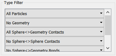

For Setup Selections - Type, select the elements in your
model to include.
By default, all particles are included in the group, and if you select
No Geometry or No Contacts,
the data will not be exported for the selected Query type.
For any element, select All,
None, or a few elements from the dropdown
list.
For selected elements, select the checkbox to include all
elements.
Elements
Filter Options
Particles
All Particles, No Particles, Selected
Particles
Geometry
All Geometry, No Geometry, Selected
Geometry
Surface - Geometry Contacts
All Surface-Geometry Contacts, No
Surface-Geometry Contacts, Selected Surface-Geometry
Contacts
Surface - Surface Contacts
All Surface-Surface Contacts, No Surface-Surface
Contacts, Selected Surface-Surface Contacts

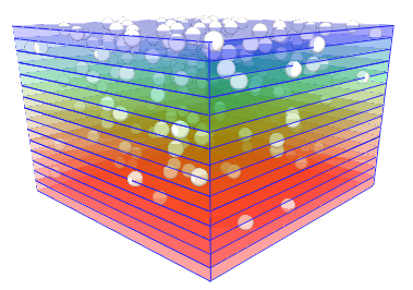

Sub-Selection Coloring
Select a query from the dropdown list. Options are:
Value Range
Set the minimum
and maximum query values either manually or read
from the model by clicking
Update. This takes the
current maximum and minimum values of the selected
query.
Auto-update
Select to
automatically update according to the Time Step
being viewed. Bins will then be colored depending
on the approximate range they fall in. The colors
used are fixed from blue (minimum), through green,
to red (maximum).
Legend
Select to display a
color legend in the Viewer.
Opacity
Select to vary the
opacity of the bin coloring. Bin groups can be
colored according to any pre-defined query. For
example, bins can be colored by the number of
collisions taking place in them, or by the average
speed of the particles they contain.
