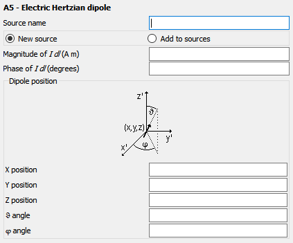

A5 Card
This card specifies excitation by an electric Hertzian dipole
On the Source/Load tab, in the Ideal sources
group, click the
Electric dipole
(A5) icon.
Parameters:
- New source
- A new excitation is defined which replaces all previously defined excitations.
- Add to sources
- A new excitation is defined which is added to the previously defined excitations.
- Magnitude of I dl (A m)
- Absolute value of the complex amplitude in Am.
- Phase of I dl (degrees)
- Phase of the complex amplitude in degrees.
- X, Y, Z position
- Coordinates of the position of the dipole in m. These values are optionally scaled by the SF card.
- angle
- Orientation of the dipole in space. The angle (in degrees) is the angle between the dipole and the Z axis.
- angle
- Orientation of the dipole in space. The angle (in degrees) is the angle between the projection of the dipole onto the Z=0 and the X axis.
