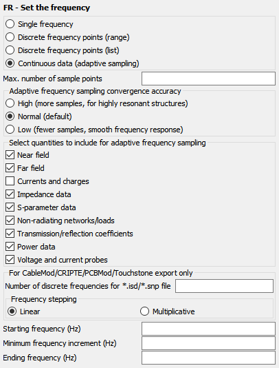

FR Card
The FR card sets the frequency/frequencies (in Hz), at which the solution will be obtained.
On the Source/Load tab, in the Settings group, click the  Frequency (FR) icon.
Figure 1. The FR - Set the frequency dialog.
The solution can be done for a single frequency, a range of discrete frequencies (linear or multiplicative stepping), a list of discrete frequencies or a continuous solution in a given frequency band with adaptive frequency interpolation with the option to set the convergence accuracy. For a continuous solution, only one FR card is allowed. Specific quantities of interest to the user may also be selected to be included for adaptive sampling. Unselected quantities will be calculated at the discrete solution frequency points.

Continuous data (adaptive sampling)
Select interpolate this item to use an adaptive frequency interpolation technique to obtain a continuous representation of the results in the given frequency band. When using this feature, the remaining parameters have the following meaning:
Max. number of sample points
Maximum number of discrete frequency points in this frequency band at which Feko may be executed (limitation to avoid convergence problems). If left empty, the default value of 1000 will be used.
Adaptive frequency sampling convergence accuracy
This allows the user to manually set the adaptive frequency sampling convergence accuracy. Note that the default setting should be used for most cases, but in special cases where a structure with many resonances is being modelled a higher convergence accuracy should be used.
Select quantities to include for adaptive frequency sampling
The quantities selected will be included in the adaptive frequency sampling.

Starting frequency (Hz)
Defines the start frequency of the simulation range.
Ending frequency (Hz)
Defines the end frequency of the simulation range.
Minimum frequency increment (Hz)
Minimum increment between adaptive samples, see the note below.
In order to obtain a continuous frequency response, the adaptive frequency interpolation technique obtains the solution at a set of discrete frequency points. They are automatically placed, for example using large frequency increments in regions with a smooth behaviour of the results, and much finer frequency increments close to resonances. Sometimes, for example when using a frequency dependent mesh, the Feko results versus frequency may contain small discontinuities. In these cases the adaptive algorithm cannot converge. (It will continue to refine the frequency increment as it tries to fit a smooth curve through the discontinuity and will only stop when the Max. number of sample points is reached.) One may avoid this by setting the Frequency increment to the minimum allowable separation distance between neighbouring frequency sample points. The value of the Frequency increment must be smaller than the resolution required to solve, for example, sharp resonances. If left empty, the default is:
