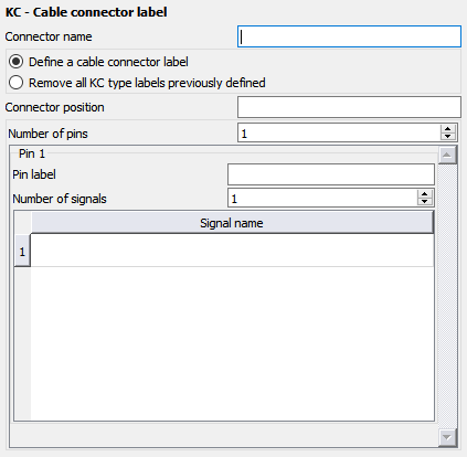

KC Card
The KC card facilitates the transferral of connector names from CADFEKO to POSTFEKO.
On the Solve/Run tab, in the Cables group,
click the
Connector (KC)
icon.
Parameters:
- Connector name
- The name of the connector.
- Define a cable connector label
- Define a cable connector label with the following parameters.
- Remove all KC type labels previously defined
- This KC card does not define a load, but rather all previously defined KC labels are deleted. All the other input parameters of this card are ignored.
- Connector position
- Data point/node to access the geometrical coordinates of this connector.
- Number of pins
- The number of pins defined in the connector.
