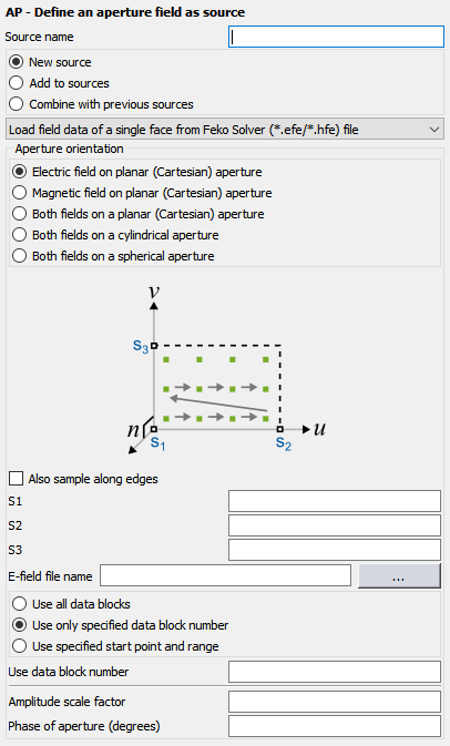

This card defines a planar, cylindrical or spherical aperture of measured or calculated field values that is converted by PREFEKO internally into an equivalent array of electric and magnetic dipoles (A5/A6 cards).
On the Source/Load tab, in the Equivalent
sources group, click the
Aperture source (AP) icon.
Parameters:

- Aperture orientation
- Here one may select a planar, cylindrical or spherical aperture. For a planar aperture
one may elect to use only electric or magnetic fields (this radiates in both directions,
see comments below).

- S1, S2 and S3
- These text boxes are for input points (see the DP card) that define the orientation of the aperture. The figure on the dialog will depict the orientation. For a planar aperture the input points define the position of the origin and the direction of the and directions respectively. (The field data is assumed to vary first along the direction.) For cylindrical and spherical apertures they define the origin and the direction of the local Z axis and X axis respectively. All angles are relative to these axes.
