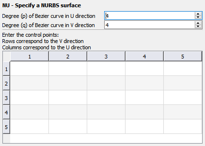

NU Card
This card defines surface triangles representing a NURBS surface.
On the Construct tab, in the Surfaces group,
click the NURBS (NU) icon.
Parameters:
- Degree (p) of Bezier curve in U direction
- The degree of the Bézier curve in the U direction.
- Degree (q) of Bezier curve in V direction
- The degree of the Bézier curve in the V direction.
It is possible to create a triangular NURBS surface. In this case all control points on one side must be identical (use the same point). The weights of the control points are specified at the DP card. Note that for higher order Bézier curves, the surface does not pass through the control points except those on the corners.
