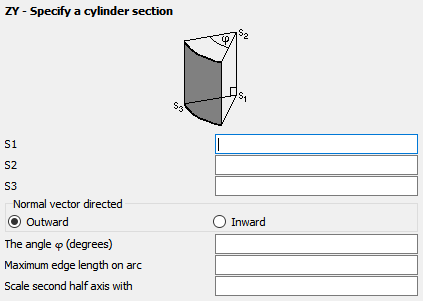

This card defines a surface mesh in the form of a cylindrical segment.
On the Construct tab, in the Surfaces group,
click the
Cylinder icon. From the drop-down list, click the
Cylinder (ZY) icon.
Parameters:
- S1
- The start point of the axis.
- S2
- The end point of the axis.
- S3
- A point on the corner of the cylindrical segment.
- Normal vector directed
- The triangles can be created so that the normal vector is points Outward or Inward.
- The angle (degrees)
- The angle in degrees, which is subtended by the cylindrical arc.
- Maximum edge length on arc
- Maximum edge length of the triangles along the curved side in m (is scaled by the SF card). If this parameter is left empty, the value specified with the IP card is used.
- Scale second half axis with
- If this parameter is empty or is set to 1 , a circular cylinder is created. If set to , an elliptical cylinder is created. Here gives the ratio of the two half axes, where a is the distance S1–S3. It is not recommended to generate elliptical cylinders with extremely small or extremely large axial ratios with a CAD system as the distortion formulation used in PREFEKO may fail in these cases.
