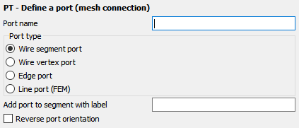

PT Card
This card defines a port connected to the full wave model. Reference this port when defining sources, loads, networks and transmission lines.
In the Source/load tab, in the Ports group,
click the
Port (PT) icon.
- Wire segment port
- Add port to segment with label
- Specifies the segment label where the port is placed.
- Reverse port orientation
- Select this option if the polarity of the port is to be reversed.
