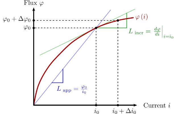

or apparent and incremental;The definitions of apparent and incremental inductances Lapp and Lincr are shown in Figure 1.
Figure 1. Apparent and incremental inductances Lapp and Lincr of an electromagnetic device, obtained from its characteristic function φ(i) at an operating point (φ0, i0).

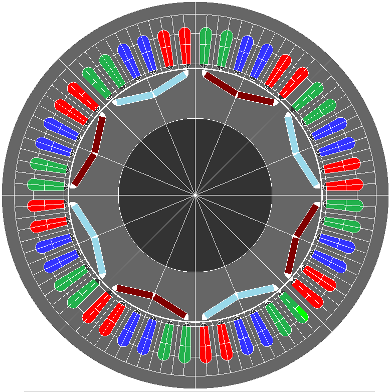

An inductance computation using this new feature has been performed in the case of the device shown in Figure 2, which is available in the catalog of examples of Flux Supervisor (under Technical tutorials, Brushless IPM motor). The device is a three-phase, eight-pole synchronous machine with a permanent magnet rotor.

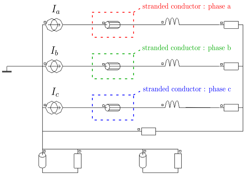

In this example, the apparent inductance matrix has been computed with Flux in the case of an imposed rotor speed of 1200 rpm. Each stator coil a, b, and c was simultaneously designated as a source and as a target coil. These windings are fed by current sources Ia, Ib et Ic in accordance with the circuit shown in Figure 3:

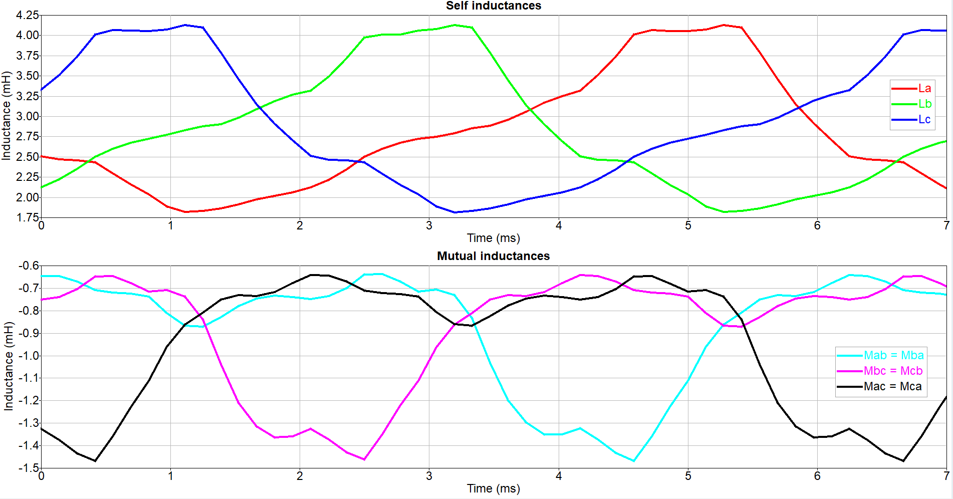

The time variations of apparent self inductances La, Lb and Lc and of apparent mutual inductances Mab=Mba, Mbc=Mcb and Mac=Mca were computed by Flux. The results are shown in Figure 4.
At each time step, the magnetic flux components φa, φb and φc linked to the three stator coils are related to the apparent inductances by the following equation:
In this last equation, terms φ0a, φ0b and φ0c represent the magnetic flux components produced by the magnets of the machine and concatenating the stator windings.
