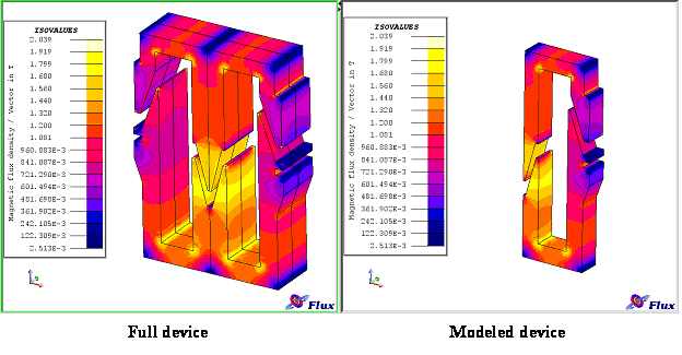

The device reconstruction permits to display two independent windows that contain:
- the view of the modeled device
- the view of the complete device (taking into consideration the symmetries/periodicities described by the user)
When to use it?
This mode of double view can be activated:
- at the construction of the project: it permits rapid and full visualization of the geometry of the device
- at the post processing of the results: it permits to display the results (isovalues, isolines, arrows…) on the full device
Display the full device
To display the view of the full device or to come back to the mode one view (Modeled device):
- in the menu View, click on Full device
or click on the icon
It is possible to display only the view of the full device and to hide the view of the modeled device by using the arrows on the separation bar of the 2 views.
To print one of the two views:
- click on the desired view
→ a green frame appears on the activated view
then print
