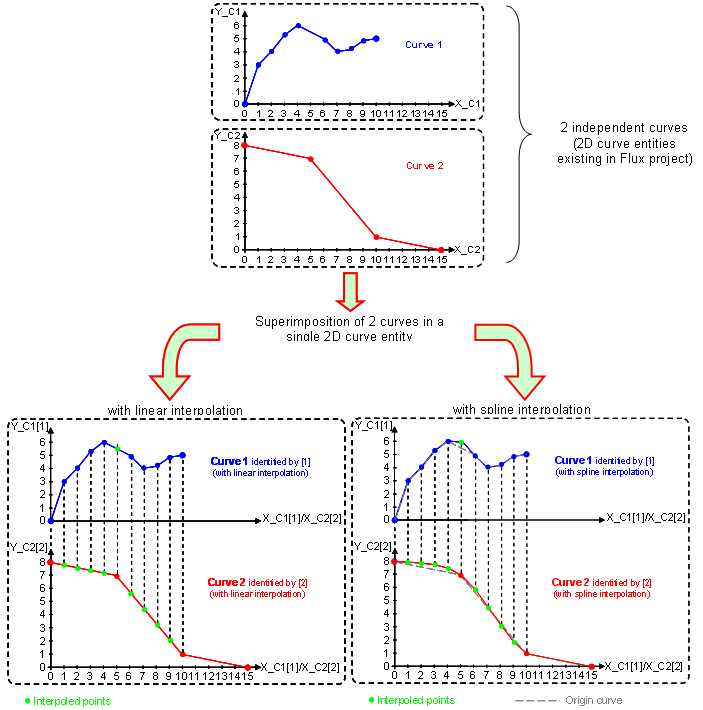

The superimposed curves may not have the same quantity on the abscissa, and they may not have the same sampling rate.
But in Flux a 2D curve entity can have several curves but all of them having the same abscissa (same quantityand same sampling).
To ensure this, when superposing the curves, an interpolation is carried out with the goal to having the same computed step for each curve by respecting the original interval of each of curves.
Principle
The figure below illustrates the operation of the interpolation during the superimposition of curves.
Identifier
The new abscissa becomes common to all superimposed curves and its name replaces the name of each of the original curves abscissas to not lose information.
The identifier 1, 2 … is associated to the label on the abscissas and ordinates axis to permit the user to identify the origin of each curves.
The identifier 1 corresponds to the first curve selected during the choice of curves to be superimposed.
