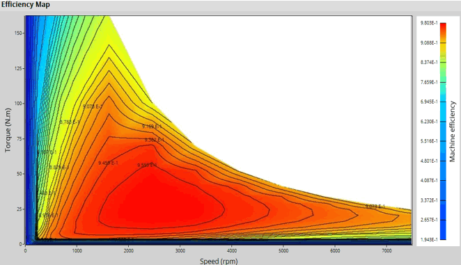

The aim of Flux e-Machine Toolbox is to characterize the behavior of the machine in the "Torque-Speed" area and allows to postprocess various quantities in this area.
Input parameters like the maximum phase voltage RMS , the maximum phase current RMS and the desired Maximum speed of the machine are considered.

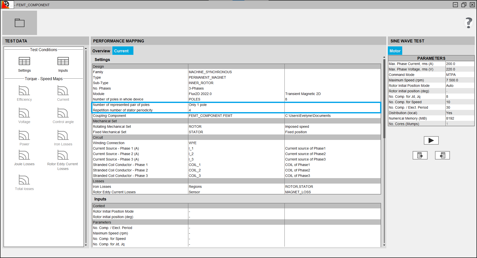

Type of machine
In these first versions, only one machine is taken into account by Flux e-Machine Toolbox. It is the Synchronous machine, permanent magnet in three phases (Inner rotor or outer rotor).

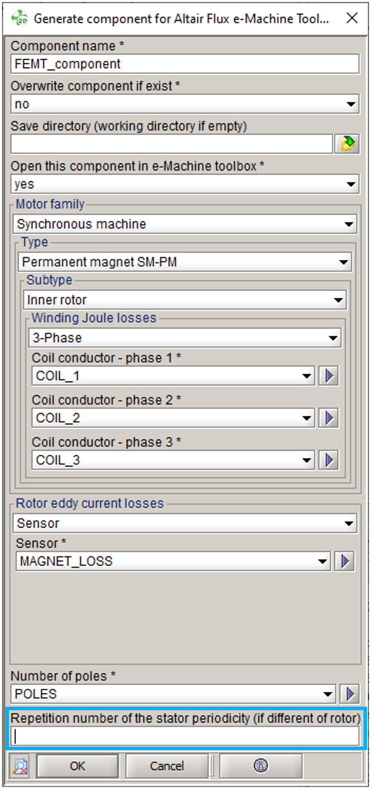

Since FeMT 2021, designs where the section represented in Flux contains multiple magnetic poles are supported. You can represent all types of machines, and in particular the fractional slot winding machines which have different periodicities in the stator winding and in the rotor.
In Flux, when generating the coupling component, there is a new field: Repetition number of the stator periodicity (if different of rotor)
- Number of represented pair of poles
- Repetition number of stator periodicity
Type of circuit connection
WYE and DELTA winding connections are supported.
- On Flux side
When generating the component, the associated circuit is automatically analysed to know if it's a DELTA or a WYE connection.
On FeMt side
When opening the coupling component in Altair Flux e-Machine Toolbox, the winding connection is displayed in the settings table, in the Circuit section.
