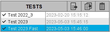

  1. Open your FEMT component previously computed with one of the two MS computation modes: MS multi-positions or MS mono-position
  2. Display the test by double_clicking on it
    → the test is displayed in the central area and the ribbon bar of possible functions appears at the top

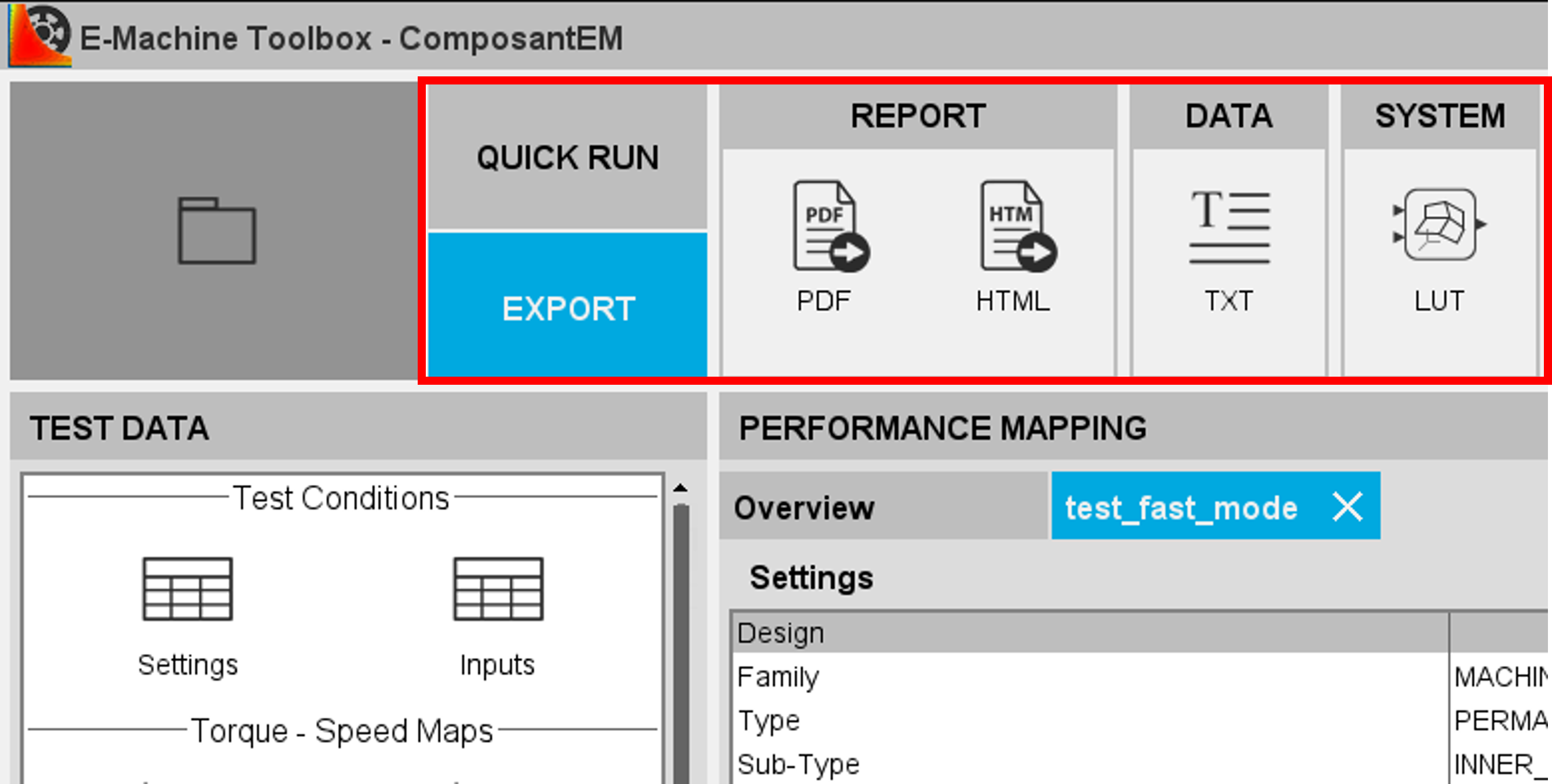

  3. Click on EXPORT
  4. Click on SYSTEM > LUT

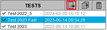

    Note: The access to this dialog box can be also:
    • by clicking on the button Export (the button in the red rectangle below)
    • or Select the test and do a right click on the test and click on Export

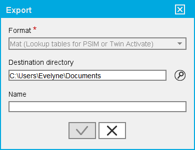

  5. Choose the Destination Directory
  6. Choose a Name
  7. Validate the dialog box

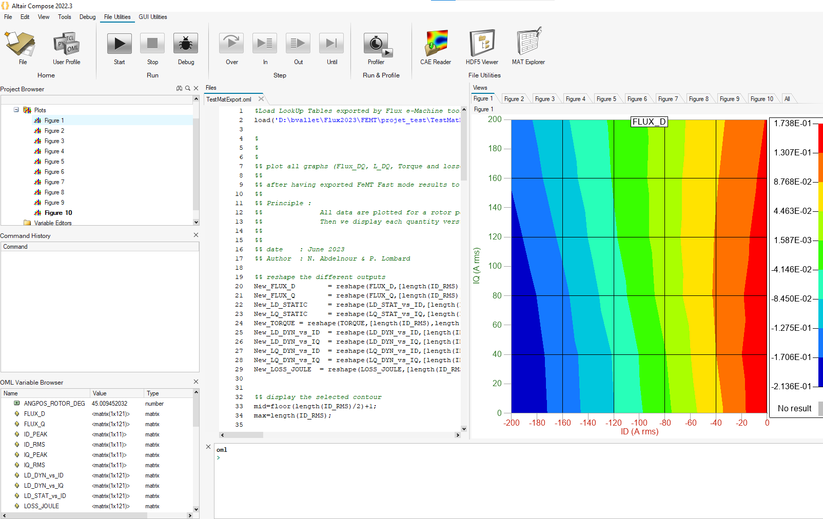

  8. Check the values and the maps in "Compose" (optional)
    1. double-click in the *.oml file
      → Compose is opened and the *.oml file is opened
    2. run the *.oml by clicking on the Start button :
      → the maps are displayed

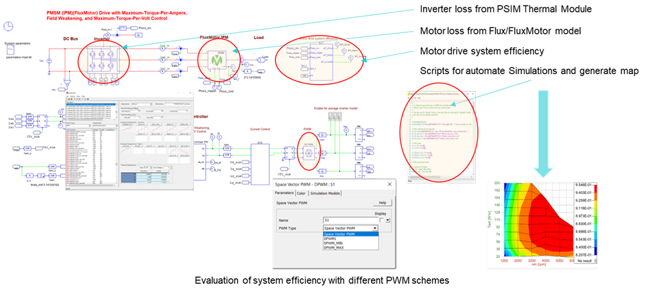

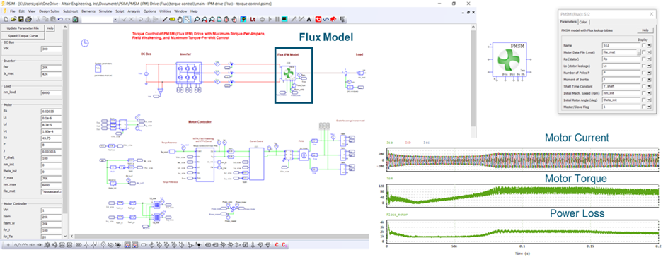

To evaluate the performance of your motor drive systems, PSIM Motor Drive Modules can be used to model a Speed or Torque control strategies of your motor.
  1. There are two PMSM (IPM) Drive (Flux) templates that are used for speed or torque control of the motor. These schemes use the mat files coming from FeMT as an input to compute the evolution of currents, torque and power for a given power electronic system.
  2. The second template uses the mat file coming from FeMT to compute efficiency maps of the complete driving system considering the inverter effects. Various PWM schemes can be selected to compute the efficiency maps.

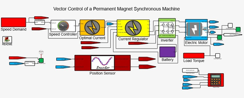

To evaluate the performance of your motor drive systems, Altair Twin Activate ElectricDrive Library can be used to model speed or torque control strategies of your motor for permanent magnet synchronous machines (PMSM).
The ElectricDrive Library for Altair Twin Activate is a collection of block libraries, scripts/macros, and example models to help build system models for an electric motor (e-motor) and drive systems, in particular for a three-phase permanent magnet synchronous motor (PMSM) based on field-oriented control (FOC), as shown below:

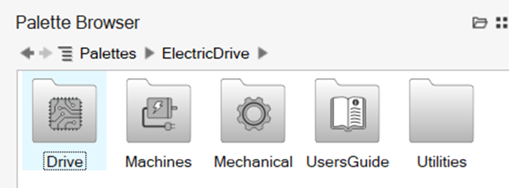

Block Library
The extension supports five categories of components as shown below:
  • Drive: Components for building drive system (speed, current controllers, etc)
  • Machines: Components for building electric machines
    Note: Currently only permanent magnet synchronous motors (PMSM) supported
  • Mechanical: Components for building mechanical systems connected to machines
  • UsersGuide: Components to access documentation about the extension
  • Utilities: Miscellaneous supporting components (e.g., Park/Clarke Transforms, Steady-State Detection algorithms, etc.)
