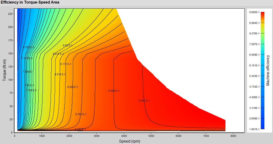

Once the test running is completed, performance maps are displayed in the central area. The filters on the left allow to display directly the performance map wished. The user has the possibility to use a cursor to display values by pointing on the map.
Performance maps
Several quantities are postprocessed in the Torque-Speed area:

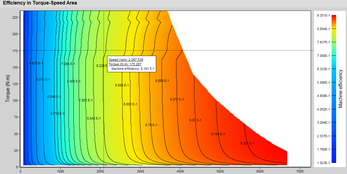

Cursor

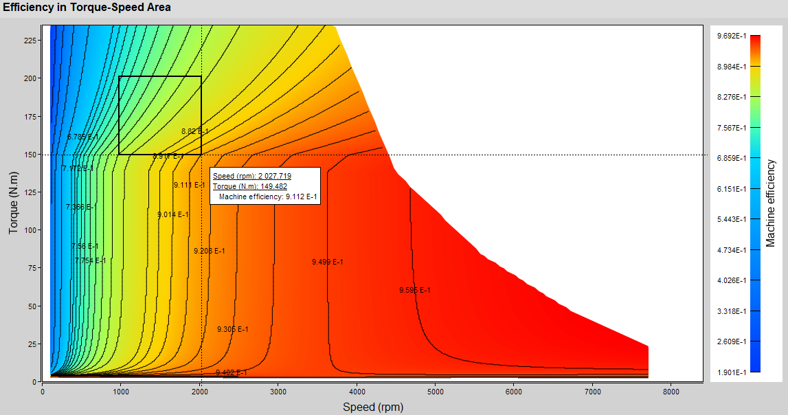

The user can display efficiency map values at the cursor position.
Scale modification
It is possible to modify the scales of all efficiency maps:
  • graphically
  • manually

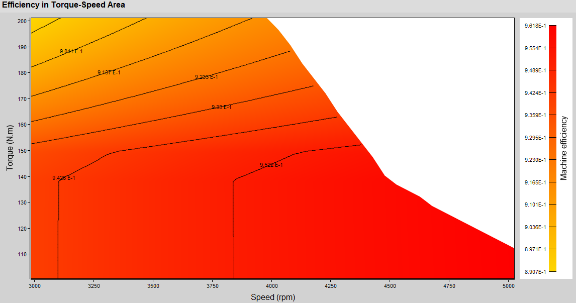

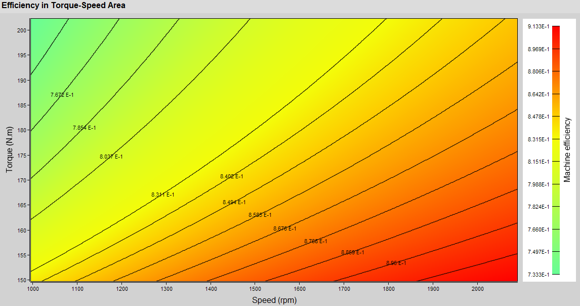

Steps for graphical modification of scales
  1. Click on
  2. On the efficiency map, do a rectangle selection
    → Map rebuilding takes a few seconds
    → Recomputed efficiency maps are updated
    Before modification After modification
    → Values are updated

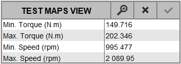

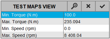

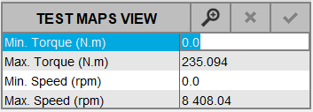

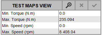

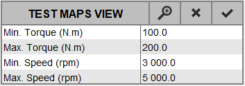

Steps for manual modification of scales
  1. Edit the value you want to modify
  2. Modify the wished value and validate with the Enter key
  3. Edit and Modify other values if you want
  4. Validate all modifications by clicking on
Important: The modification is applied to all displayed efficiency maps.
Note: After modification, it is possible to reset the scale values by clicking on
Note: These modifications are only taken into account when displaying efficiency maps. The new values are not taken into account when exporting a test.

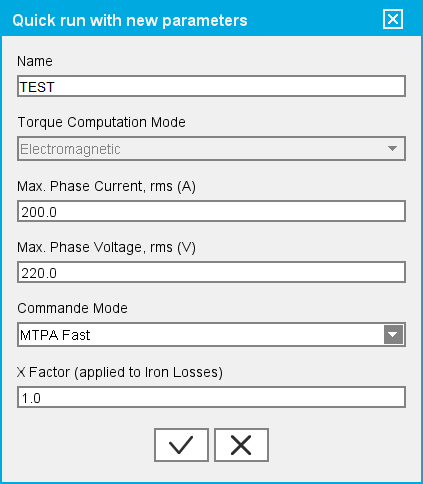

Quick run with new parameters
It's possible to create and run a new test with new values of some parameters. The possible parameters to modify are the parameters which no need a re-solving of the Flux project, but only a re-compute and re-display of maps.
The possible parameters to modify for a quick run are:
  • Torque Computation Mode
  • Max. Phase Current, rms (A)
  • Max. Phase Voltage, rms (V)
  • Command Mode (MTPA/MTPV)
  • X Factor (applied to Iron Losses)
The maps will be updated in only few seconds.

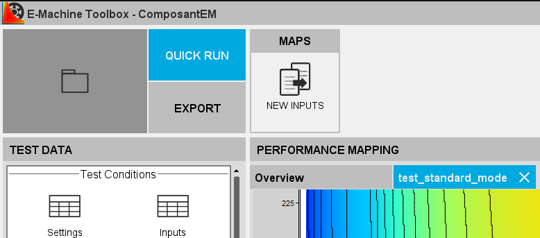

Here are the steps to quickly run a test:

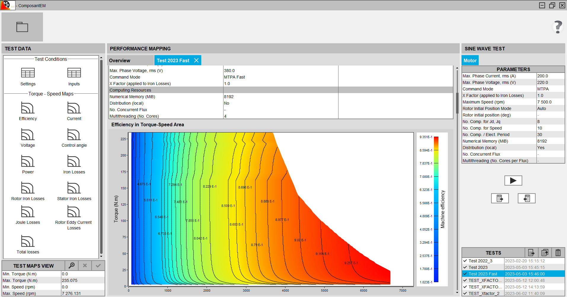

  1. Open the Quick run with new parameters dialog box:
    Display the wished test by double click on it.
    → the test are displayed on the center area in a new tab
    → The ribbon with Quick Run button appears
    Note: It's also possible to open the Quick run dialog box:
    • by selecting the test in the list and by clicking on
    • or by a right-click on the test and by selecting in the contextual menu → Quick run
    → the dialog is opened
  2. Fill the fields with the new customs values and validate
    → a new test is automatically created in the TESTS table and the maps are generated in few seconds

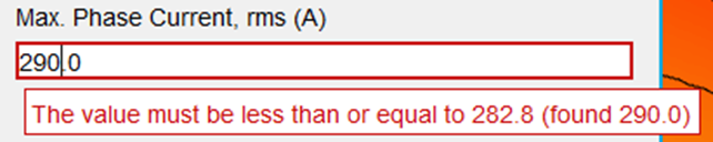

Restriction: Because of the extrapolation process used to compute the post-processed test with new command, the new value for “Max. Phase Current, rms (A)” should follow the constraints bellow:
  • Imax is the initial value of the “Max. Phase Current, rms (A)”. It will always be the value of the original fully computed test, even if the test is post-processed from another post-processed test.
  • Then ImaxNew should be 0.5*Imax ≤ IMaxNew ≤ Imax otherwise extrapolation may cause accuracy loss. A warning message is displayed in that case.
  • ImaxNew < √2*Imax otherwise an error message will be displayed
