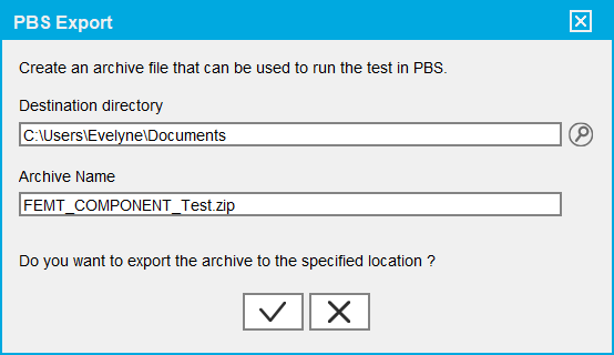

- Export to PBS
In FeMT, export all the required files for PBS by clicking on the button:
→This will generate an archive (.zip file)
The PBS Export window opens:
- Select the Destination Directory in which
the archive will be created by clicking on the
button - Enter the Archive Name. The default name of the archive is <FeMT_coupling_component_name>_Test.zip
- Click on the
button

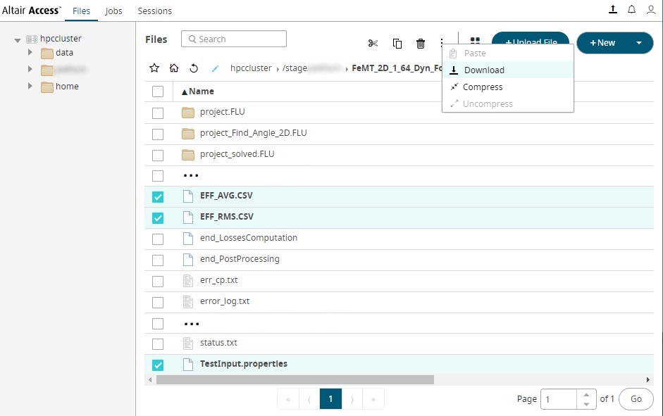

- Once the computation is finished
- Select the 3 files with the name:
- EFF_AVG.CSV
- EFF_RMS.CSV
- TestInput.properties
- Click on the
button and then on the
Download menu→ This will create an archive (.zip file)

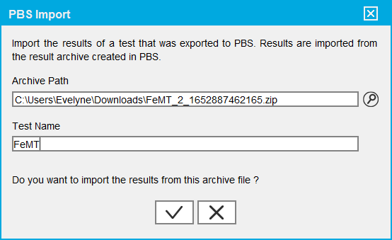

- Import from PBS
In FeMT, import the results from PBS by clicking on the button:
The PBS Import window opens:
- Select the Archive Path (i.e. the full
path to the .zip file just created in PBS)
by clicking on the
button - Enter a Test Name (the name of the test which will appear in FeMT)
- Click on the
button
by clicking on the
