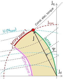

- Command mode:
- either MPTA: Maximum Torque Per Ampere
- either MTPV: Maximum Torque Per Volt

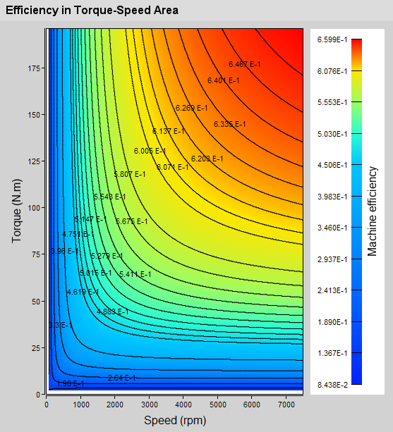

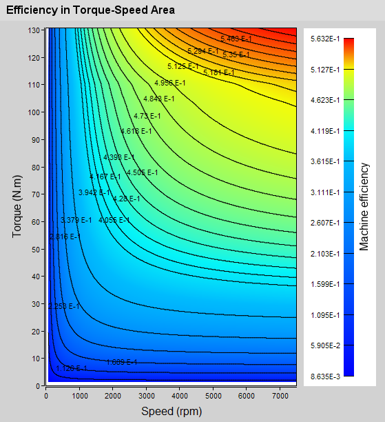

Input parameter - Motor tab: X Factor
The X Factor allows the user to adjust the iron losses to his measurements and recompute the efficiency of his motor with a better accuracy. The X Factor is a floating value by which the iron losses amplitude is multiplied. The default value is 1.
The X Factor can be accessed:
- before solving: in the Input Parameters
- after solving: in Post-process with a New Command
- Iron Losses (Rotor + Stator) in Torque-Speed Area
- Rotor Iron Losses in Torque-Speed Area
- Stator Iron Losses in Torque-Speed Area
- Total Losses in Torque-Speed Area (including Iron Losses)
So with the MS mono-position computation mode, the X Factor is not available.

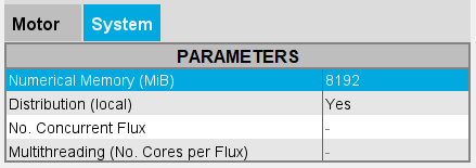

Input parameters - System tab: Numerical Memory
Numerical memory allocated to the solving process of the Flux project:
Since FeMT 2021, there is a new memory mode to run tests: the Dynamic memory mode.
From now on, there are two memory modes: User (static) and Dynamic.
- If the User (static) memory mode is used, then the
numerical memory value (in MiB) allocated to the solving process of the Flux
project is displayed. The user can modify this value.

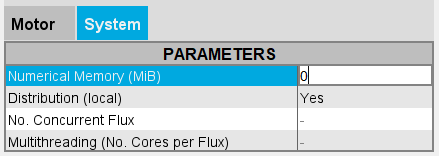

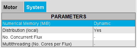

On the other hand, the user can switch to the Dynamic numerical memory mode by entering 0.
Note: For FeMT versions prior to 2022.1, the user could not switch to the Dynamic memory mode in FeMT. In order to run tests in Dynamic memory mode, the user had to regenerate the coupling component from a Flux running in Dynamic memory mode. - If the Dynamic memory mode is used, then
Dynamic is displayed and the numerical memory used is
dynamically managed by Flux during its execution. So in this mode, the user does
not set any value for the numerical memory.

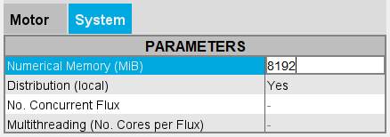

On the other hand, the user can switch to the User numerical memory mode by entering a numerical value in MiB.
Warning: When switching from Dynamic numerical memory mode to User numerical memory mode, the user must know the numerical memory required to solve the project and therefore set a high enough value.

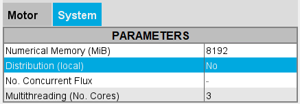

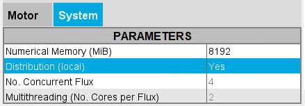

Input parameter - System tab: Distribution (local)
- If the Distribution (local) is set to
Yes
- If the distribution is activated in the Flux Supervisor that is to say that it has already been configured (Number of Concurrent Flux and Number of cores per concurrent Flux) and that you want to use distributed computing, then the solving will be distributed.
- If the distribution is not activated in the Flux Supervisor then the solving will be sequential and not distributed even if the Distribution (local) is set to Yes.
No then the solving will be sequential, not distributed.

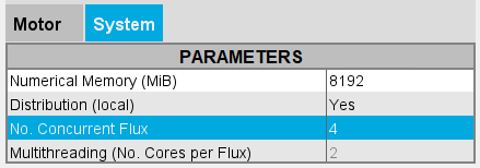

Input parameter - System tab: No. Concurrent Flux
This field defines the number of Flux that can be running at the same time during a distributed computation.
This number of concurrent Flux is not accessible to the user here, it is grayed out.
Yes
- If in the field No. Concurrent Flux there
is a value n, then this indicates that
the distribution has already been configured i.e. that this
value has been previously set in the Flux Supervisor. So, for
the solving, n Flux will be run in parallel.Warning: A great number may render difficult the use of the machine for other tasks until the solving completes.

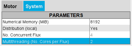

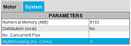

Input parameter - System tab: Multithreading (No. Cores)
This field defines the number of cores used during a solving. More precisely, it is the number of cores used by the application for multithreaded algorithms. The application uses at least 1 core.
Yes
- If in the field Multithreading (No. Cores per
Flux) there is a value m,
(note: this value is not accessible to the user here, it is
grayed out), then this indicates that the distribution has
already been configured i.e. that this value has been previously
set in the Flux Supervisor. So, for the solving,
m cores per concurrent Flux will be used.
- If in the field Multithreading (No. Cores per Flux) there is no value, then this indicates that the distribution has not been activated in the Flux Supervisor. And so the solving will be sequential and not distributed even if the Distribution (local) is set to Yes.

However, even if the solving is sequential, the number of cores will be used for multithreaded algorithms.
Default values are set for the field Multithreading (No. Cores):- For a 2D project, the number of cores is 1 by default
- For a Skew project, the number of cores is 2 by default
- For a 3D project, the number of cores is 4 by default
This value corresponding to the number of cores can be modified by the user. The maximum value the user can enter is of course the total number of cores of the machine.
