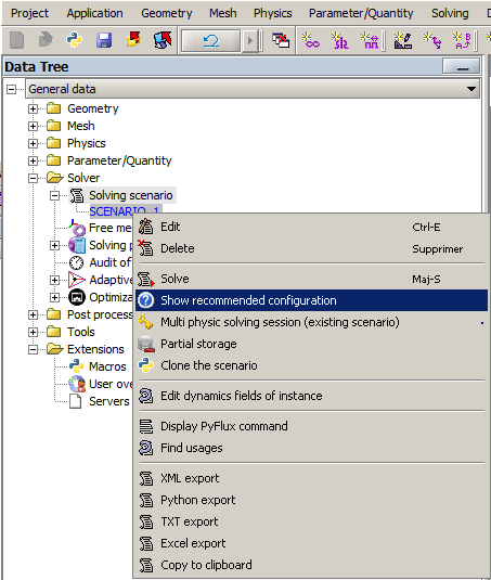

The recommendations may be obtained by right-clicking a scenario in the Data Tree and then selecting the Show recommended configuration command, as shown in Figure 1:
Figure 1. Right-clicking on a scenario in the Data Tree for selecting the Show recommended command.
