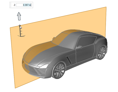

Edit the size of the section cut plane in the modeling window by completing one of the following:
- In the microdialog, click
and edit the sizing values. - Click an edge of the plane and drag the arrow to lengthen or shorten the
selected side of the plane.
Figure 4.
Move the section cut plane in the modeling window.
- Select the section cut plane.
In the microdialog, select
- Use the graphical manipulator to move or rotate the section cut plane.
