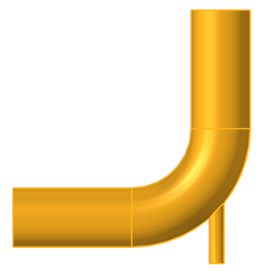

The problem characteristics shown here determine if the flow is laminar or turbulent by calculating the Reynolds number in the pipe. The diameter of the large inlet is 0.1 m, and the inlet velocity (v) is 0.4 m/s. The diameter of the small inlet is 0.025 m, and the inlet velocity is 1.2 m/s.
Figure 1. Schematic of Mixing Elbow
The fluid in this problem is water with the following properties that do not change with temperature: a density (ρ) of 1000 kg/m3 and a molecular viscosity (μ) of 1 X 10-3 kg/m-sec.
Based on mass conservation, the combined flow rate (Q) yields a pipe velocity of 0.475 m/s downstream of the small inlet. The following equations are used to calculate the pipe velocity:

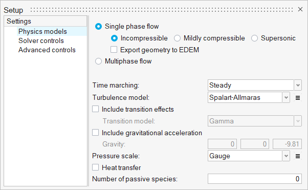

  2. Under the Physics models setting:
    1. Verify that the Incompressible option is selected under Single phase flow.
    2. Set the Time marching to Steady.
    3. Select Spalart-Allmaras as the Turbulence model.
      The robustness and accuracy of the Spalart Allmaras turbulence model makes it an excellent choice for simulation of steady state flows.
    Figure 6.

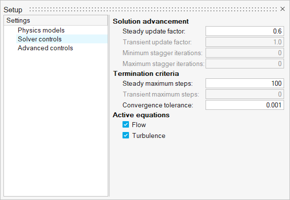

  3. Click the Solver controls setting and verify that the parameters are set as shown in the figure below.
    Figure 7.

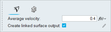

  3. In the microdialog, enter a value of 0.4 m/s for Average velocity.
    Figure 12.

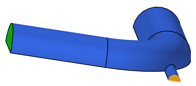

  1. Click the face of the small inlet.
    Figure 13.

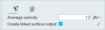

  2. In the microdialog, enter a value of 1.2 m/s for Average velocity.

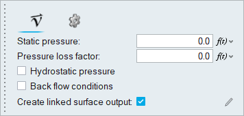

Set Boundary Conditions for the Outlet
  1. From the Flow ribbon, click the Outlet tool.
    Figure 15.

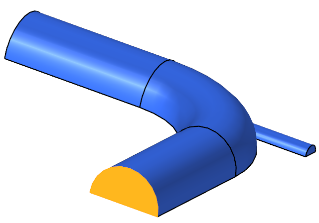

  2. Click the face of the outlet.
    Figure 16.
  3. In the microdialog, make sure the Static pressure is 0 Pa and the Pressure loss factor is also 0.
    Figure 17.
  4. On the guide bar, click to execute the command and exit the tool.

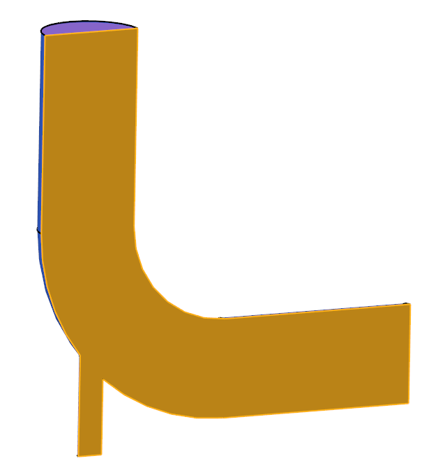

Set Boundary Conditions for the Symmetry Plane
This geometry is symmetric about the XY midplane, and can therefore be modeled with half of the geometry. In order to take advantage of this, the midplane needs to be identified as a symmetry plane. The symmetry boundary condition enforces constraints such that the flow field from one side of the plane is a mirror image of that on the other side.
  1. From the Flow ribbon, click the Symmetry tool.
    Figure 18.

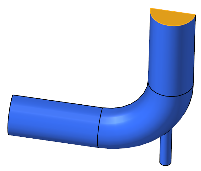

  2. Select the face of the symmetry plane.
    Figure 19.
  3. In the microdialog, accept the default symmetry conditions.
    Figure 20.

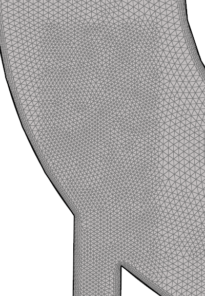

  2. Check that the Average element size is 0.025 m.
  3. Accept all other default parameters.
    Figure 22.
  4. Click Mesh.
    The Run Status dialog opens. Once the run is complete, the status is updated and you can close the dialog.
    Tip: Right-click on the mesh job and select View log file to view a summary of the meshing process.
  5. From the back side of the model, observe the refined mesh around the small inlet.

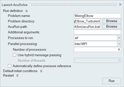

  1. From the Solution ribbon, click the Run tool.
    Figure 24.
    The Launch AcuSolve dialog opens.
  2. Set the Parallel processing option to Intel MPI.
  3. Optional: Set the number of processors to 4 or 8 based on availability.
  4. Deactivate the Automatically define pressure reference option.
  5. Leave the remaining options as default and click Run to launch AcuSolve.
    Figure 25.

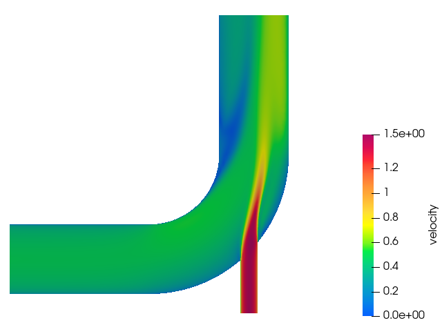

  4. Isolate the Symmetry flow boundary in the Post Browser.
  5. Right-click on Symmetry and select Edit.
  6. In the display properties microdialog, set the display to velocity and activate the Legend toggle.
  7. Click and set the Colormap Name to Rainbow Uniform.
    Figure 26.
  8. Click on the guide bar to show the velocity magnitude (m/s) contour.

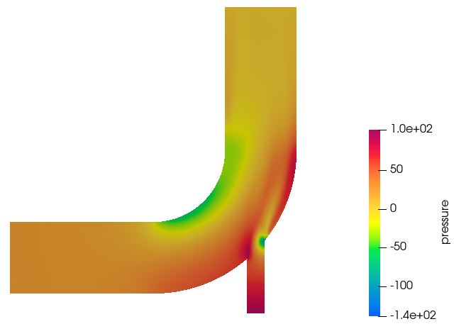

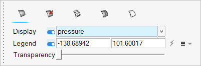

  9. Again, right-click on the Symmetry and select Edit.
  10. Display the pressure (Pa).
  11. Click to reset the range.
    Figure 28.
  12. Click on the guide bar to show the pressure (Pa) contours.
    Figure 29.
