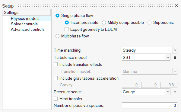

The Setup dialog opens. -
Under the Physics models setting:
- Verify that the Incompressible option is selected under Single phase flow.
- Set the Time marching to Steady.
- Select SST as the Turbulence model.
Figure 7.

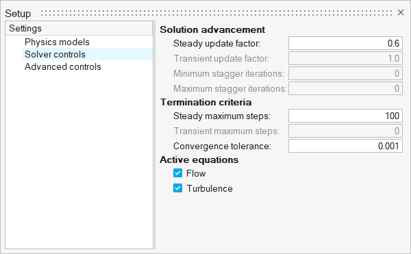

- Click the Solver controls setting.
Set the Steady update factor to 0.6, the Steady maximum
steps to 100, and the Convergence tolerance to
0.001.
Figure 8.
- Close the dialog and save the model.

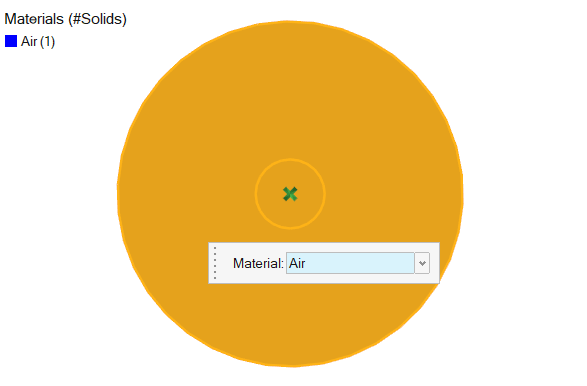

Verify the Material Selection
Figure 9.

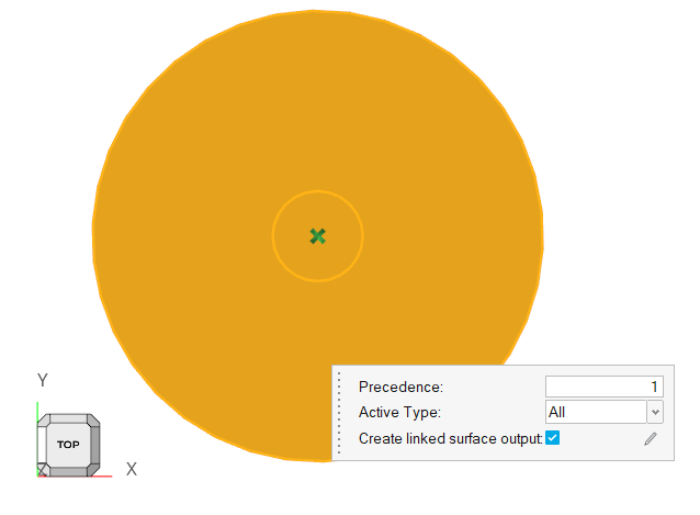

Select the model body.
The entire solid is highlighted.
Figure 10.

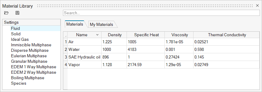

- In the microdialog check that the material Air is assigned by default.
Click the Material Library tool to verify the material
properties of air.
Figure 11.
Air should have the following properties.
- Density: 1.225
- Specific Heat: 1005
- Viscosity: 1.781e-5
- Thermal Conductivity: 0.02521
Figure 12.
- Close the dialog.

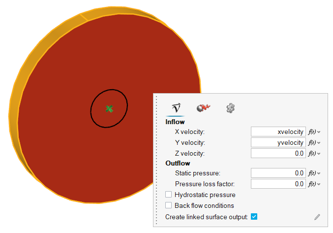

Rotate the geometry slightly so that the side-surfaces are visible. Click on
the two half-side surfaces as shown in the figure below. In the microdialog, type xvelocity and
yvelocity in the respective velocity fields. Accept
all other default parameters
Figure 16.

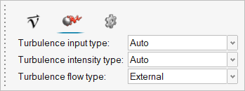

Click the Turbulence tab in the microdialog and select External for
the Turbulence flow type. Accept all other default parameters.

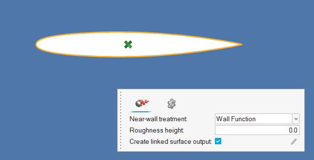

Click the No Slip tool.
Figure 24.
- Scroll to zoom in so that the airfoil surface is clearly visible.
Right-click in the modeling window and choose to select the entire airfoil profile.
Figure 25.
Click
on the guide bar.
- Using the Boundaries legend, rename Wall (30) to Airfoil.
On the guide bar, click
to execute

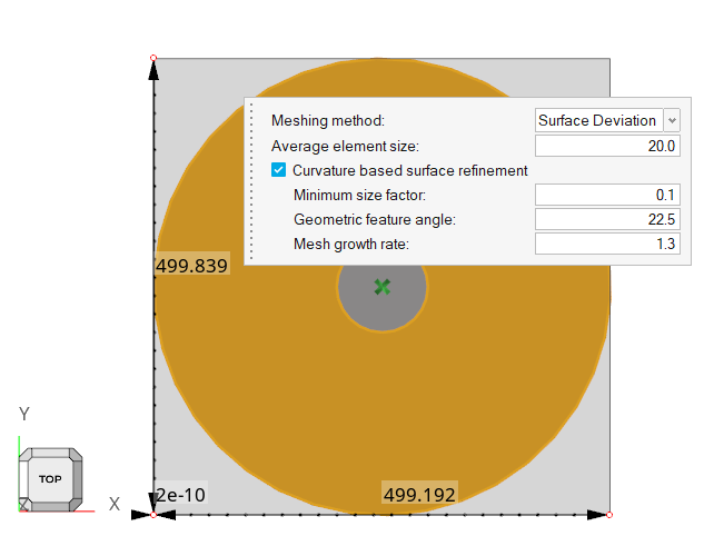

Set Surface Mesh Controls
From the Mesh ribbon, click the Surface tool.
Figure 26.

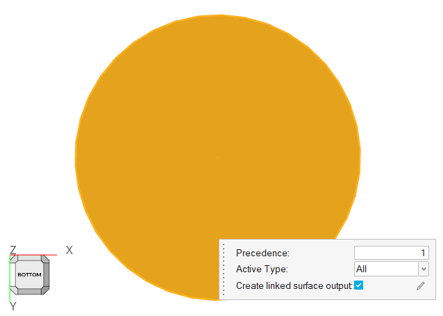

- Select the outer circular surface shown in the figure below.
In the microdialog, set the Average element size to
20 and make sure the Minimum size factor (0.1),
Geometric feature angle (22.5), and Mesh growth rate (1.2) are entered as shown
below.
Figure 27.
Click
on the guide bar.

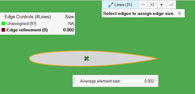

Set Edge Mesh Controls

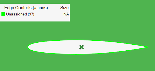

Click the Edge tool.
Figure 30.
Zoom in on the airfoil.
Figure 31.

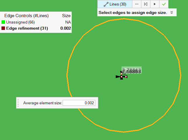

Right-click in the modeling window and select .
This also selects the edge of the smaller circle, which will be unselected in the next step. The total number of lines selected is (31).
In the microdialog, enter a value of
0.002 for Average element size.
Figure 32.
Click
on the guide bar.

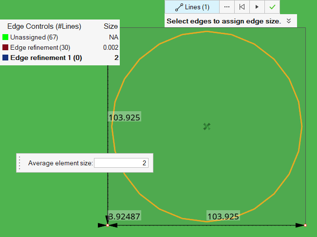

- Zoom out until the edge of the smaller circle appears.
Right-click Edge refinement(31) and select
Edit. Keep the cursor on the highlighted edge of the
smaller circular. Press Shift and left click to deselect
the smaller circular edge so that the total lines selected becomes (30).
Figure 33.
Click
on the guide bar.
Keep the mouse on the smaller circle edge line and click it. Enter the value of
2 for the Average element size.
Figure 34.
Click
on the guide bar.

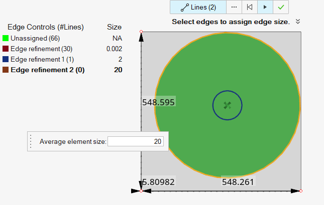

Select the two outer edges of the outer circle and enter a value of
20 for the Average element size.
Figure 36.
Click
on the guide bar.
The Edge Controls legend shows the status of the updated events.Figure 37.

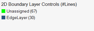

Set Edge Layer Controls
- Zoom in on the airfoil.

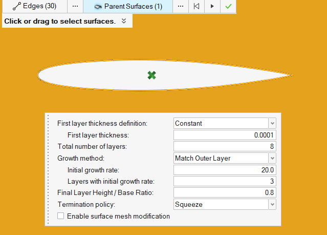

Click the Edge Layer tool.
Figure 38.

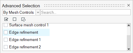

besides the Edges selector.
In the Advanced Selection dialog, select By
Mesh Controls and enable Edge
refinement.
Figure 39.

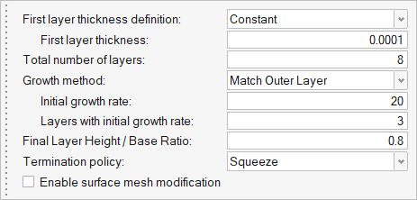

In the microdialog, select
Constant for First layer thickness definition. Enter
a value of 0.0001 for First layer thickness and
20 for the Total number of layers for generating mesh
boundary layers. Select Constant for Growth method, enter
a value of 1.2 for Growth rate, and verify a value of
0.8 for Final Layer Height/Base Ratio. Accept all
Figure 40.

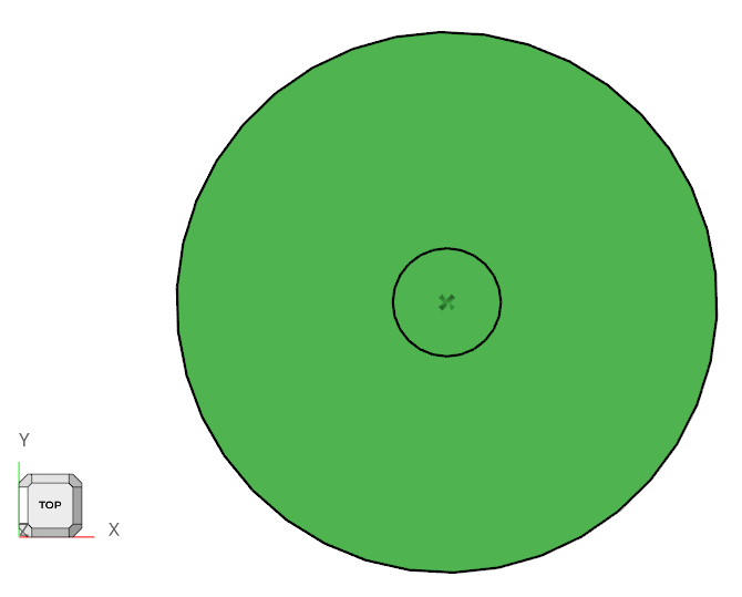

Close the Advanced Selection dialog then click
Parent Surface on the guide bar and select the smaller circular surface (around the airfoil) as shown
below.
Figure 41.
Click
on the guide bar.
The 2D Boundary Layer Controls legend shows the status of the updated events.Figure 42.
to execute

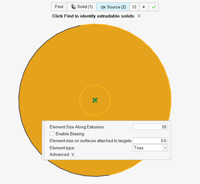

Set Extrusion Controls
Click the Extrusion tool.
Figure 43.
Click Find on the guide bar.
This finds all the solids with mappable surfaces for extrusion.
Click Solid (1).
This selects all solids automatically.
- Click Source then select the model surface.
50 for Element Size Along Extrusion and
0.6 for Element size on the surfaces attached to
targets. Accept all other default parameters.
Figure 44.
Click
on the guide bar, observe
the change in the legend, then click
- Save the database.

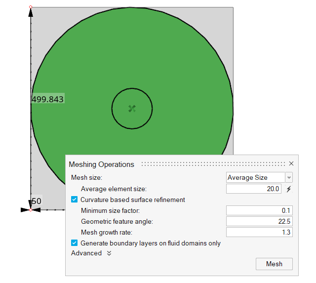

Volume tool.
Figure 45.
The Meshing Operations dialog opens. -
Check that the Average element size is 20. Accept all other default
parameters.
Figure 46.
Click Mesh.

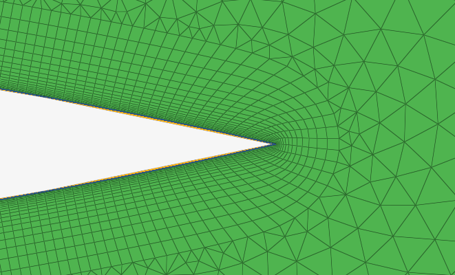

The Run Status dialog opens. Once the run is complete, the status is updated and you can close the dialog.Tip: Right-click on the mesh job and select View log file to view a summary of the meshing process.
Click Mesh Only on the View Controls toolbar.
This is used to enable or disable the visualization of mesh.
Figure 47.

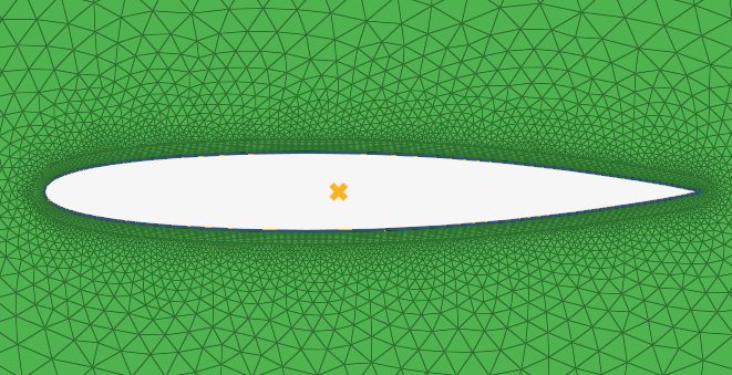

Zoom in to check the mesh layers closer to the airfoil surface.
Figure 48.
Zoom towards the trailing edge of the airfoil to view the mesh.
Figure 49.

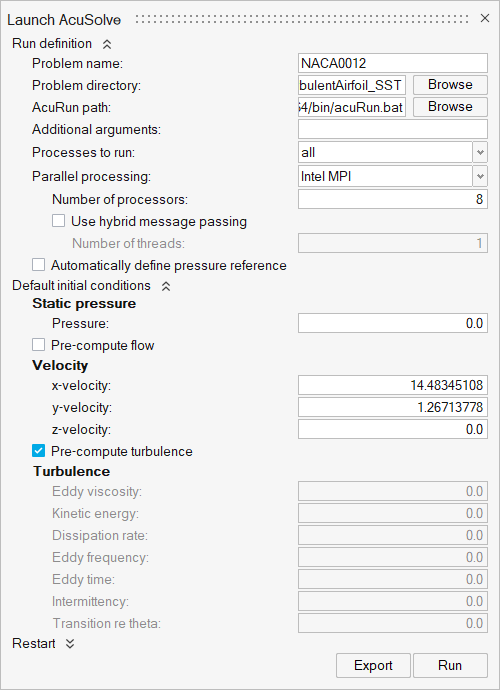

Run AcuSolve
Figure 52.
The Launch AcuSolve dialog opens. - Set the Problem name to NACA0012.
- Set the Parallel processing option to Intel MPI.
- Deactivate the Automatically define pressure reference option.
Expand Default initial conditions, turn off
Pre-compute flow, and set x-velocity yo
14.48345108 and y-velocity to
1.26713777823. Enable Pre-compute
turbulence.
Figure 53.
Click Run.

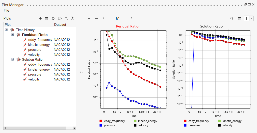

Post-Process the Results with HM-CFD Post

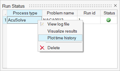

Once the solution is completed, right-click on the AcuSolve run in the Run Status
dialog and select Plot time history.
Figure 54.
The Plot Manager shows the Residual and Solution Ratios.Figure 55.
- Close the dialog.

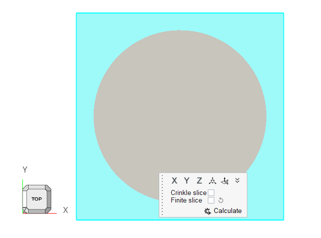

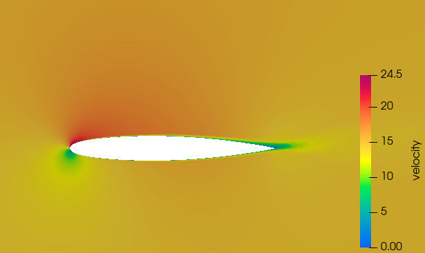

Figure 56.
Select the x-y plane in the modeling window.
Figure 57.
Click
to create the slice plane.

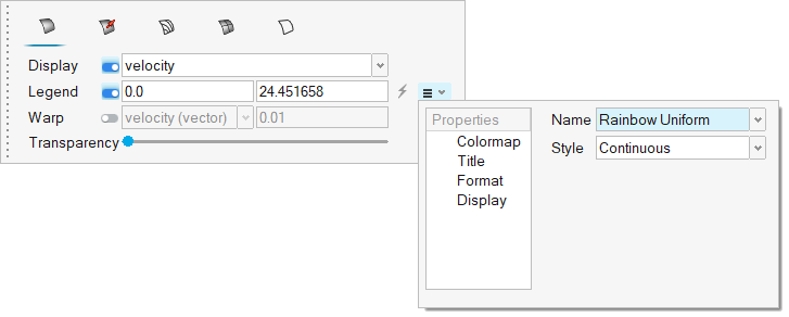

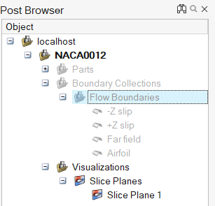

- In the display properties microdialog, set the display to velocity and activate the Legend toggle.
Click
and set the Colormap Name to Rainbow
Uniform.
Figure 58.
Click
on the guide bar to
visualize the sqrt eddy period contour.
In the Post Browser, click the icon beside Flow
Boundaries to turn off the display for all the flow

Zoom in on the airfoil to see the contour.
Figure 60.

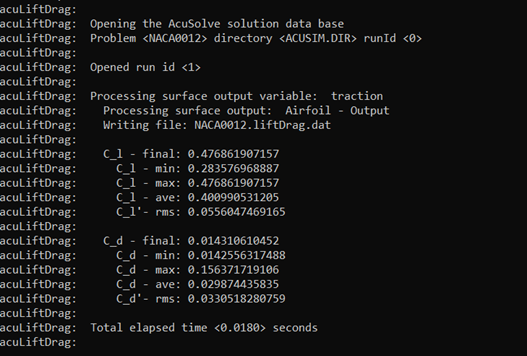

Run AcuLiftGrag
In the Problem Description section, it was described that the simulation is performed as 2D by including only a single layer of extruded elements in the airfoil span direction. When solving a problem in such a way, the span of the airfoil should be set equal to the thickness of the domain in the extrusion direction. When solving a 3D problem, the actual span of the airfoil should be used.
To execute the AcuLiftDrag script for this position, follow the steps below:- Start AcuSolve Command Prompt from the Start menu by clicking .
- Change the directory to the present problem directory using the cd command.
Enter the following command at the prompt:
acuLiftDrag -osis "Airfoil - Output" -aoa 5 -ref_vel 14.54 -chord 1 -ref_rho 1.225 -span 50
The output of the command should look like the image below:Figure 61.
The value C_l corresponds to the lift coefficient, and C_d corresponds to the drag coefficient. The final keyword refers to the respective coefficient values at the last time step of the simulation. The rest of the values provide the basic statistics for these coefficients over all the time steps of the simulation. These statistics are more meaningful if the simulation is transient.
The script also creates the file NACA0012.liftDrag.dat in the problem directory. The file contains the lift and drag data for all the available time steps in a determined tabular arrangement. The first column is the time step, the second column is the lift coefficient, and the third column is the drag coefficient.

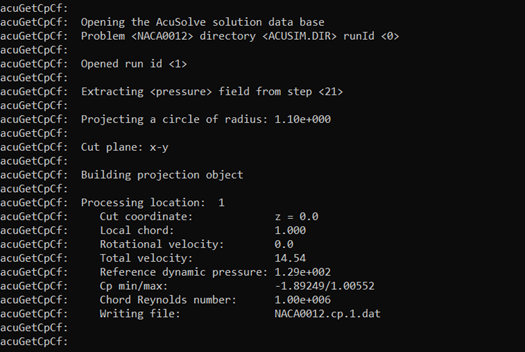

AcuGetCpCf
AcuGetCpCf is another utility script used to calculate the coefficient of pressure (Cp) and coefficient of friction (Cf) for the airfoil.
To execute the AcuGetCpCf script for this problem, follow the steps below:
Enter the following command at the prompt to extract Cp and save it to the file
with the .dat extension
acuGetCpCf -osis "Airfoil - Output" -type cp -ref_vel 14.54 -ref_rho 1.225 -no_nc -ref_pres 0 –cut_dir z –rad_locs 0.0
The cut_dir option describes the cut plane axis to calculate the Cp and Cf values. rad_locs describes the location of the cut plane on the cut_dir axis. The script prints the minimum and maximum values for the pressure coefficient. It also creates a file, NACA0012.cp.1.dat, in the problem directory. The file contains the pressure coefficient data along the chord of the airfoil. The first column is the x-coordinate along the chord, and the second column is the pressure coefficient
The output of the command should look like the image below:Figure 62.

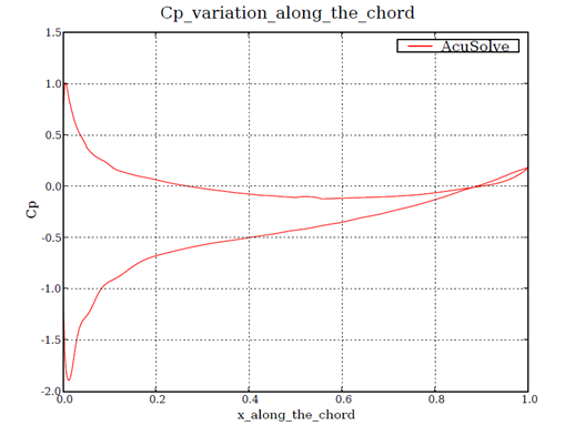

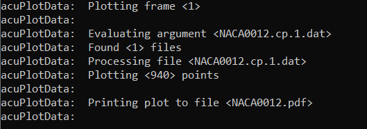

Enter the following command at the prompt to plot the variation of Cp along the
airfoil surface, or you can use an external plotting utility to the plot the
data.
acuPlotData -files NACA0012.cp.1.dat -x_col 1 -y_cols 2 -no_pts -ptf -lfmt "-r" -legend AcuSolve -title Cp_variation_along_the_chord -x_label x_along_the_chord -y_label Cp
Figure 63.
The plotting result is shown below:Figure 64.
