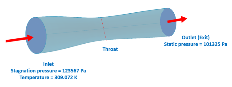

Problem Description
The exit to throat area ratio of the nozzle is 1.5. The radius at the inlet is 0.892 m, while the radius at the outlet is 0.691 m. The inlet stagnation pressure and the inlet temperature are 123,567 Pa and 309.072 K, respectively. The static pressure at the outlet is set to 101,325 Pa. The fluid in this problem is air, where the flow is assumed inviscid (viscosity and conductivity are zero) and density is based on the ideal gas model.

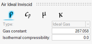

The Material Library dialog opens. - Under Settings, click Ideal Gas, and then click the My Material tab.
Click
to add a new ideal gas model.

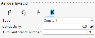

- Keep the default values for the Gas constant and the Specific heat and set the Viscosity and Conductivity values to 0.
Rename the model to Air Ideal Inviscid.

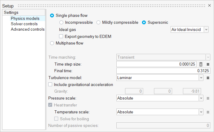

The Setup dialog opens. -
Under the Physics models setting:
- Select the Supersonic radio button under Single phase flow.
- Set the Ideal gas model to Air Ideal Inviscid.
- Set the Time step size to 0.000125.
- Set the Final time to 0.3125.
- Verify that the Turbulence model is set to Laminar.
Figure 8.

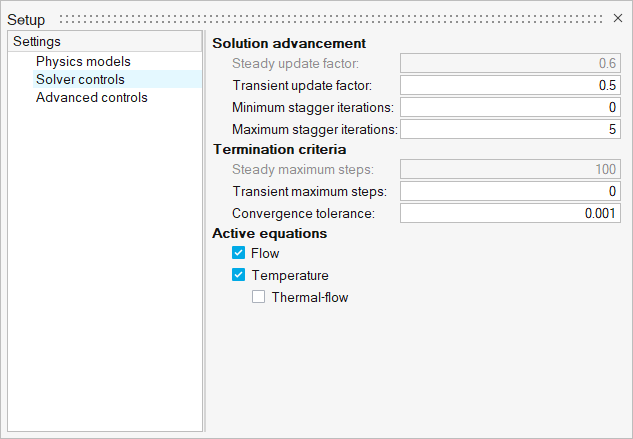

- Click the Solver controls setting.
Set the Transient update factor to 0.5.
Note: Since we are interested in a solution that reaches a steady state, the transient update factor can be set to a non-zero value without affecting the solution accuracy.
Set the Maximum stagger iterations to 5.
Figure 9.

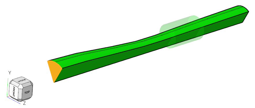

Click on the inlet face highlighted in the figure below.
Figure 12.

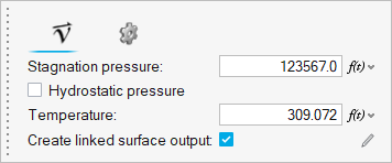

In the microdialog, enter the following values for the
stagnation pressure and temperature.
Figure 13.

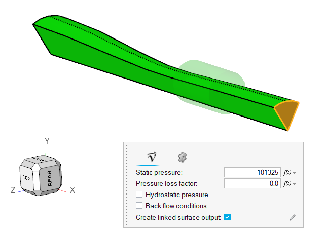

Click the Outlet tool.
Figure 14.
Select the face highlighted in the figure below, enter the
101325 as the static pressure value, and then click
on the guide bar.

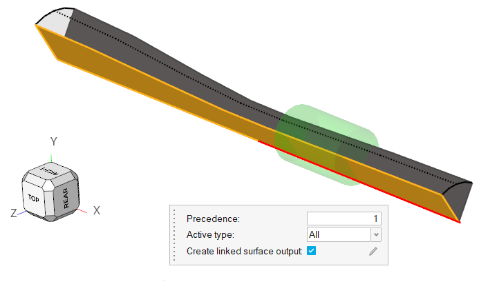

Figure 15.

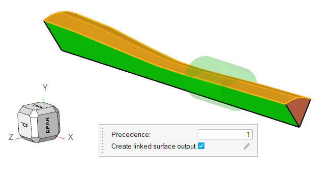

Click the Slip tool.
Figure 16.
Select the face highlighted in the figure below and then click
on the
guide bar.

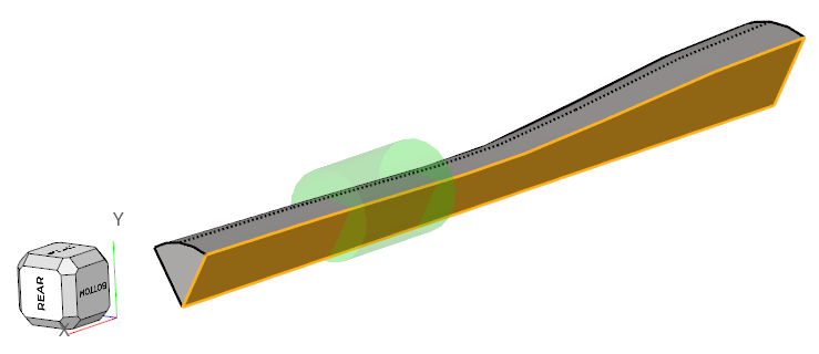

Figure 17.
Click the tool.
Figure 18.
Select the face highlighted below as the Source.
Figure 19.
Click Target on the guide bar
then select the opposite face.
Figure 20.

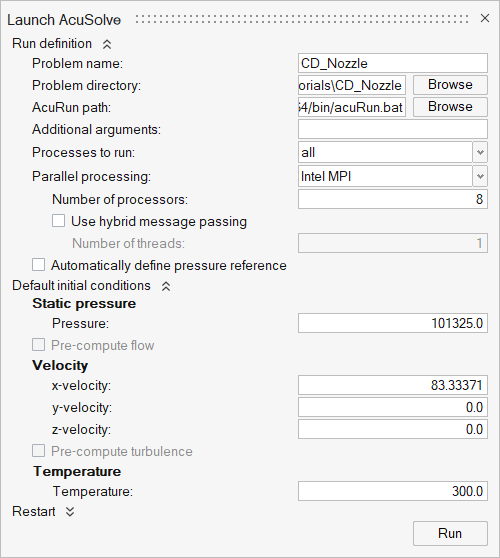

Run AcuSolve
Figure 23.
- Set the Parallel processing option to Intel MPI.
- Expand Default initial conditions and enter the values as shown below.
Leave the remaining options as default and click
Run to launch AcuSolve.
Figure 24.
The Run Status dialog opens. Once the run is complete, the status is updated and you can close the dialog.Tip: While AcuSolve is running, right-click on the AcuSolve job in the Run Status dialog and select View Log File to monitor the solution process.

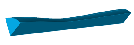

The solid and all the surfaces are loaded in the Post Browser.
Figure 25.
Move the animation slider to the end to load the last time step data.
Figure 26.

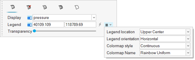

- In the display properties microdialog, set the display to pressure and activate the Legend toggle.
Click
and set the Legend location to Upper
Center, the Legend Orientation to
Horizontal, and the Colormap name to
Rainbow Uniform.

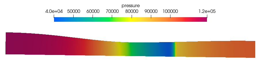

Click
on the guide bar.

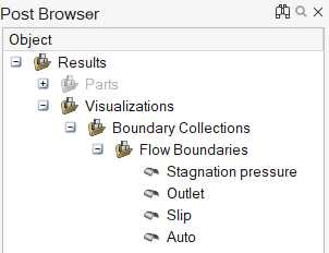

In the Post Browser, hide the Flow
Boundaries surfaces to display the pressure contours on the
slice plane.
Figure 29.

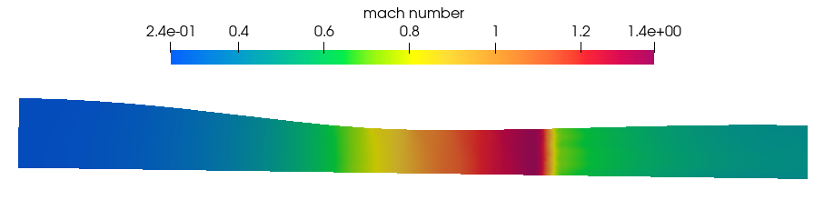

Similarly, you can display the Mach number contour.Figure 30.
