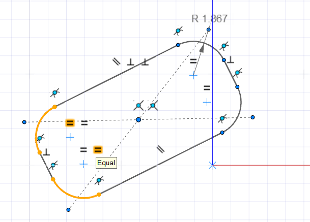

- To apply the same radius to all fillets, select the Uniform Radius = button on the microdialog.
Right-click and mouse through the check mark to exit, or
double-right-click.
The fillets are created with the dimensions of the radii indicated.Tip: To see which fillets have the same radius, hover over an equal sign. Fillets with the same radius are highlighted in yellow.
