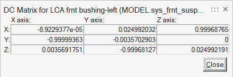

Direction Cosines
The direction cosines’ matrix is the transformation matrix that maps coordinates from the global reference frame to the current coordinate system. The three columns of the direction cosines’ matrix are unit vectors along the x, y, and z axes of the coordinate system in terms of the global frame.
Click [DC] to view the direction cosines’ matrix for a coordinate system.
