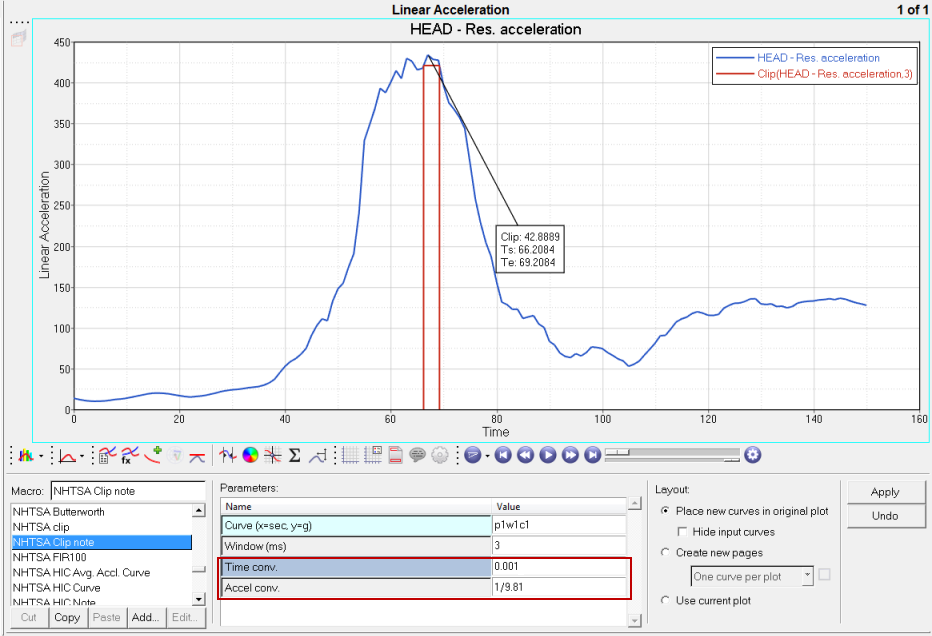

In the image below, units are not enabled for the selected curve. After loading the curve, select a vehicle safety tool (VST) function such as clip from the Injury menu. Without units enabled, you must manually enter the scaling factors in the Timv conv. and Accel conv. fields so that the curve fits properly.

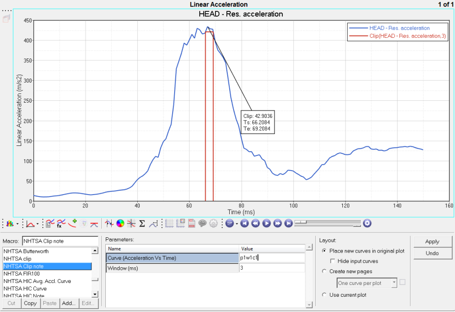

However, with units enabled, and with the same curve and VST function selected, there is no need to manually adjust the scaling factors; the scaling is applied automatically. Notice in the image below, the Time conv. and Accel conv. fields are no longer there.
With units enabled, you can also use the Convert Units context-sensitive menu to change the axes values from ms to s for the Time axes in the image below, or from m/s2 to gravities for the Linear Acceleration axis below. Doing this does not affect the values as shown in the curve note shown in this image; they will remain the same.

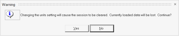

If units are not enabled and you return to the File > Preferences dialog to enable them, the HyperGraph session is cleared. The message shown below is displayed. Click Yes to clear the session with units enabled.
