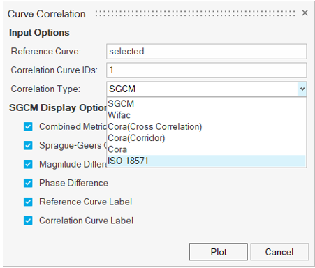

Open the Curve Correlation Dialog
- From the File menu, click to open the Create Curves by File dialog.
- From the Open File dialog, navigate to your working directory and select a file to open and plot some curves.
- From the Plot Browser, select a reference curve, right-mouse click, and select Curve Correlation.
- From the Correlation Type drop-down menu, select a correlation method.
- Select Cora to display the following options.
- Retain the default settings or change the defaults per your requirements and
click Plot.
Notes are displayed with the correlation metrics in the plot window.

- Correlation Type
- Supported methods include:
- SGCM
- Wifac
- Cora(cross correlation)
- Cora(Corridor)
- Cora
- ISO-18571

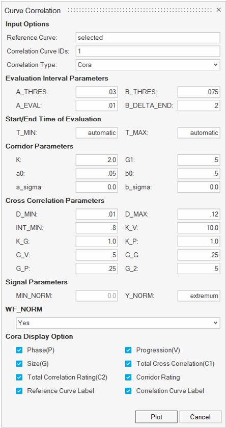

Cora Parameters
- Evaluation Interval Parameters
- Description
- A_THRES
- Threshold to set the start of the interval of evaluation. Varies between 0 and 1.
- B_THRES
- Threshold to set the end of the interval of evaluation. Varies between 0 and 1.
- A_EVAL
- Automatically calculated interval of evaluation. Varies between 0 and 1.
- B_DELTA_END
- Shortens the end of the interval of evaluation if it is calculated automatically. Varies between 0 and 1.
- Tmin/Tmax
- Defines the start and the end time of the evaluation interval.
- Corridor Parameters
- Description
- K
- Exponent factor (progression) for the calculation of the corridor rating.
- G-1
- Weighting factor of the corridor rating.
- a0
- Width of the inner and outer corridor.
- b0
- a_sigma
- Factors of the standard deviation to widen the inner corridor.
- b_sigma
- Factors of the standard deviation to widen the outer corridor.
- Cross Correlation Parameters
- Description
- D_MIN
- Calculates the interval of evaluation. Varies between 0 and 1.
- D_MAX
- INT_MIN
- Minimum overlap of the interval. Varies between 0 and 1.
- K_V
- Exponent factor (progression) of the calculation of the progression rating, V.
- K_G
- Exponent factor (progression) of the calculation of the size rating, G.
- K_P
- Exponent factor (progression) of the calculation of the phase shift rating, P.
- G_V
- Weighting factors of the progression rating.
- G_G
- Weighting factors of the size rating.
- G_P
- Weighting factors of the phase shift rating.
- G_2
- Weighting factors of the cross-correlation method.
- Signal Parameters
- Description
- MIN_NORM
- The limit to start the special treatment of the secondary axis. Varies between 0 and 1.
- Y_NORM
- Calculation type of Y_NORM; options include extremum or value.
- WF_NORM
- Normalization of the weighting factors; options include YES or NO.

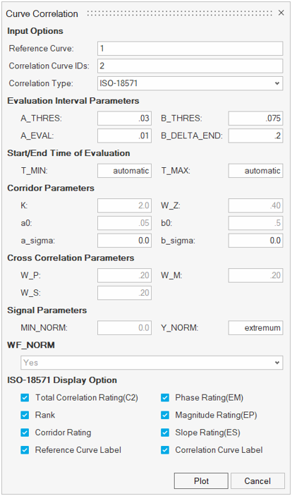

Select ISO-18571 to display the following options:
ISO-18571 Parameters
- A_THRES
- B_THRES
- A_EVAL
- B_DELTA_END
- Tmin/Tmax
- Keyword that defines the start and end time of the interval of evaluation.
- K
- W_Z
- a0
- b0
- a_sigma
- b_sigma
- W_P
- Weighting factor of the phase score.
- W_M
- Weighting factor of the magnitude score.
- W_S
- Weighting factor of the slope curve.
- Signal Parameters
- MIN_NORM
- The limit to start special treatment of a secondary axis. Varies between 0 and 1.
- Y_NORM
- WF_NORM
Cora Display Options
- Phase(P)
- Display the phase value.
- Progression(V)
- Display the progression value.
- Size(G)
- Display the size value.
- Total Correlation Rating(C2)
- Display the total correlation rating value.
- Total Cross Correlation Rating(C1)
- Display the total cross correlation rating value.
- Corridor Rating
- Display the corridor rating value.
- Reference Curve Label
- Display the reference curve label.
- Correlation Curve Label
- Display the correlation curve label.
ISO-18571 Display Options
- Phase Rating(EM)
- Display the phase rating value.
- Rank
- Display the rank value.
- Magnitude Rating(EP)
- Display the magnitude rating value.
- Corridor Rating
- Slope Rating(ES)
- Display the slope rating value.
