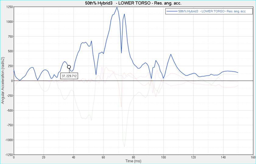

selected.When a curve is clicked in Inspect mode, the following behavior is displayed:
- The curve reverts back to its specified curve color, and all other curves in the plot fade out.
- Circular markers appear at the curve's data points. The other curves on the plot are hidden, or fade into the background.
- The legend only displays the selected curve and only the axes associated with the curve is displayed.

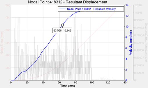

- When you hover the mouse pointer over a data point on a curve, the data point coordinates are displayed in a temporary note.
- When you move the mouse pointer over a non-highlighted curve, the curve is pre-highlighted in its original color, instead of the standard gold pre-highlighting color.
- Double-click on a curve to highlight the curve in the browser.
Clicking anywhere in an empty space in the plot while a curve is isolated causes the rest of the curves in the plot, as well as the axes, to once again be visible in the plot and the legend.
To turn off the Inspect mode, double-click anywhere in the plot (but not on the curve) to return the window to its normal state.Note: While pre-highlighting is available in all HyperGraph plot types (XY Plot, Bar Chart, Complex Plot, and Polar Plot), Inspect is only available for XY Plot and Complex Plot.Figure 1. Plot with Inspect mode enabled
Figure 2. Plot with Inspect mode enabled, with a curve selected.
Note: Notice the visible data points, temporary pop-up note, reduced legend size, and faded out curves in the background. - Pre-highlighting of Plot Attributes

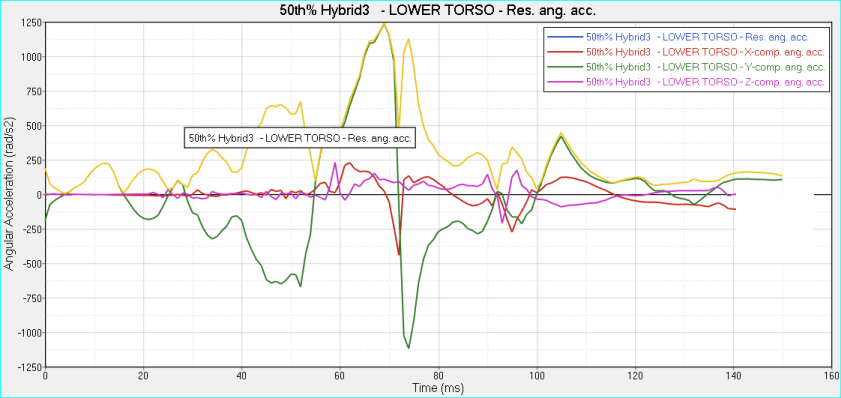

Figure 3. A pre-highlighted curve, with the curve name displayed in a temporary note.

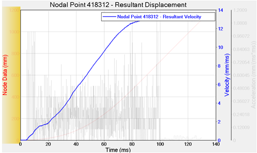

Figure 4. A pre-highlighted axis.

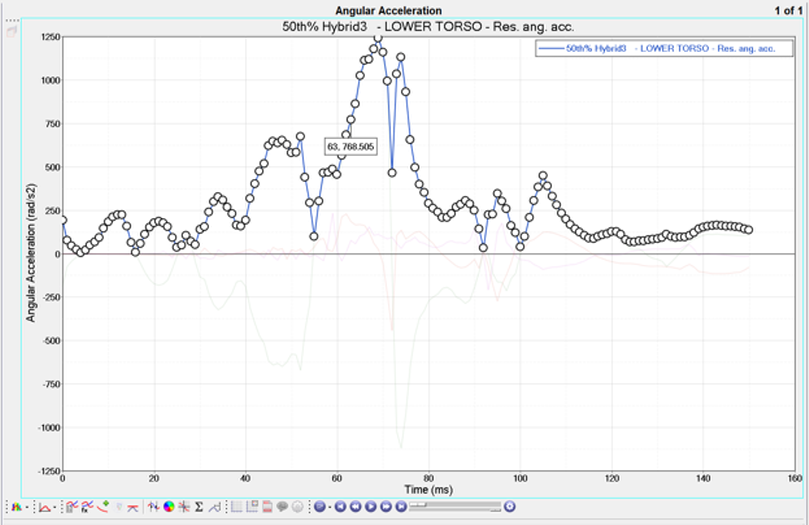

- Data Point Markers
- Circular markers are displayed at the curve’s data points when a curve is selected while in Inspect mode. If data points are so close together that the markers overlap by a distance more than 50% of the radius of the markers, only the circular marker closest to the mouse pointer the will be shown.
