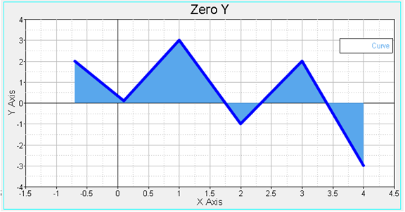

- Zero Y
- Shades from the X axis (y = 0) to the curve.

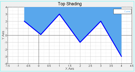

- Top
- Shades everything in the plot above the curve.

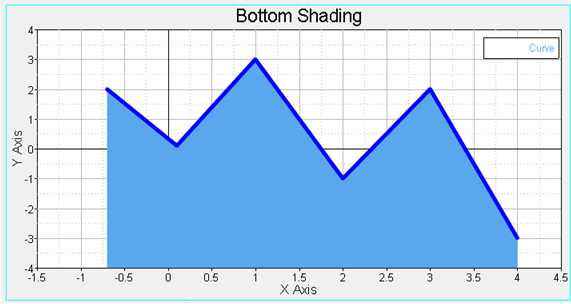

- Bottom
- Shades everything in the plot below the curve.

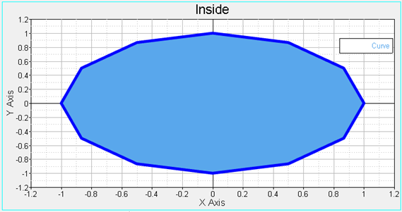

- Inside
- Shades within the polygon created by the curve.

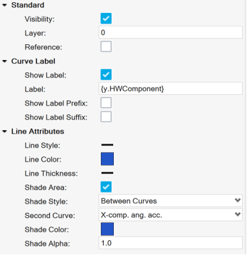

- Between Curves
- Shades between two curves.

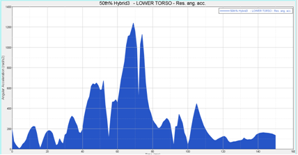

The following curve images illustrate the different shading styles.
Note: The grid lines are visible as this curve is designated as a reference curve.
