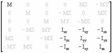

- Verify that the mass and inertias of the body are the same as the FEA and/or CAD model. To determine the mass and inertias in a HyperMesh model, select the File menu, Export option.
- From the Template box, click Load and open the file install_directory\hw11.0\templates\summary\optistruct\mom_of_inertia. Write out a file for this specific model.
- Open the created file and select the last matrix on the output titled Inertia Matrix
for Model (Using Center of Gravity As Center). The data is presented in the following
manner, where the required values are bold:
