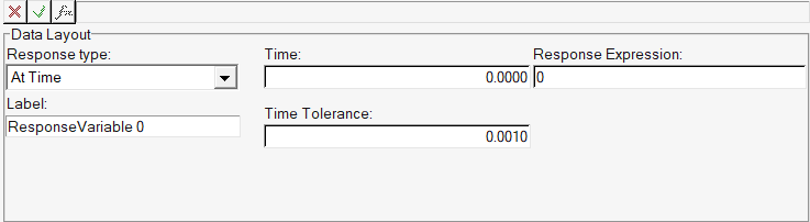

- At Reference Signal Value
- At Time
- For a given expression, captures the value of the expression at a given time.

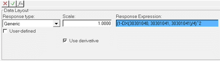

- To make a system parameter attain a specific value, you can use a
Generic type of RV. For example, to allow
an expression: Fx (displacement of mass held by a spring) to reach a
target value: T (10mm), use a Generic type of RV with its
Response Expression defined as shown
below:Response Expression =
Thus, as the value of Fx approaches T, the value of this response is minimized.

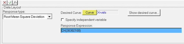

- To match a specific system behavior to a desired input curve, you
can use a Root Mean Square Deviation type of
RV. This computes RMS deviation between the desired and actual
curves.
Figure 3.
Thus, having an objective to minimize this response, will help attain the desired behavior.
