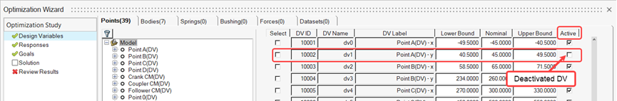

To deactivate a design variable, clear the check box for the desired DV located
under the Active column.

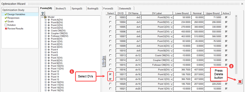

To delete a design variable, select the DV by checking the box located under
the Select column and then clicking the Delete
button.

- If the designable entity (whose data-member has been used to create a DV) is deactivated, then such design variable will be greyed out and will not be used in the optimization study.

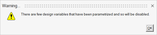

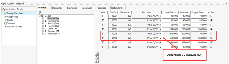

- If the data-member corresponding to an existing DV is made parametric
(or dependent) outside the Optimization Wizard, then that DV will be
disabled (or greyed out as shown below) and will not be considered for
the optimization study. A warning will also be displayed when the wizard
is launched.
Figure 3.
Figure 4.
