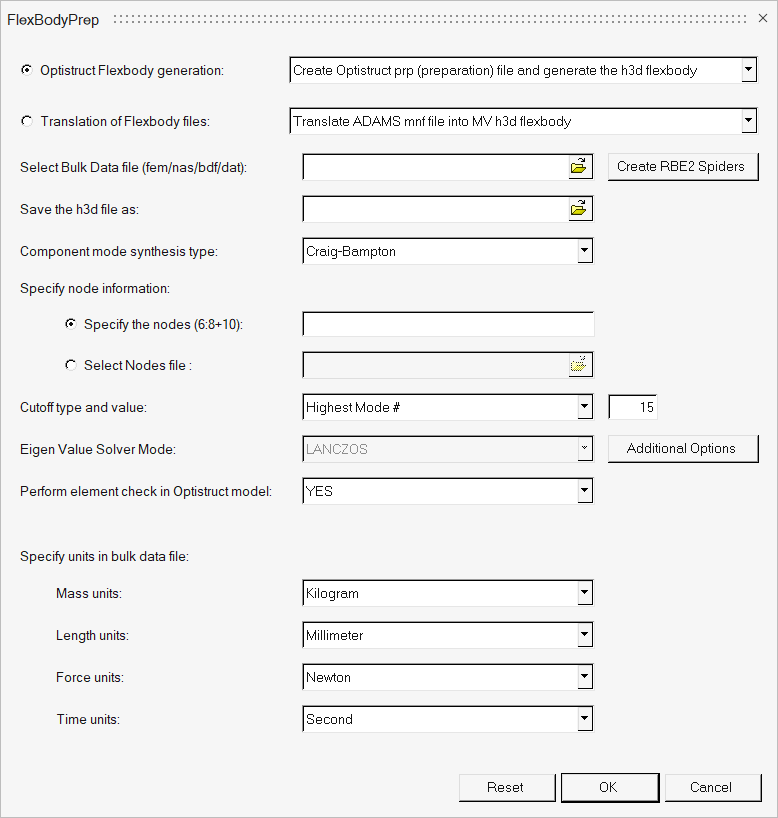

| When you select either of the above options, the following fields are displayed: | |||
| Select Bulk Data file (fem/nas/bdf/dat) | Select the OptiStruct source file that you want to convert. | ||
| Create RBE2 spiders | A utility to assist you with adding rigid spiders to
your original OptiStruct input file. Clicking this option will invoke HyperMesh and import the specified bulk data file. The Utility tab in HyperMesh can be used to generate RBE2 elements. |
| Save the *.h3d file as or Save the *prp file as |
Enter a filename and directory to which you want to save the H3D output file or the PRP file. The field displayed depends upon the conversion type you select. | ||
| Component mode synthesis type | Select one of the following options: | ||
| Craig-Bampton | Craig-Bampton obtains constrained eigen modes and static correction modes with a final orthonormalization step. | ||
| Craig-Chang | Craig-Chang obtains unconstrained eigen modes and a static analysis. | ||
| Craig-Bampton- Geometric-Stiffness | Uses the Craig-Bampton method with geometric stiffness to consider geometric
stress stiffening effects. See Comment 5 below. |
| Craig-Chang Contact | Use the Craig-Chang method to include additional contact modes. Refer to the comment below. | ||
| Specify node information | Provide a list of interface nodes. You can identify
the nodes which will be candidates for interface nodes for the later step of MDL
implementation. It is important that only interface nodes and not sensor nodes be
identified at this point. Two options are available to provide this
information:
| Specify the nodes (6:8+10) | If this option is chosen, you can enter ranges, such as 4:12, or combinations, such as 4:12 +14. | ||
| Select Nodes file | This option is useful when there are a very large set of node numbers to be provided. The text file can contain a plain list of node numbers separated by a comma or space. The numbers can be provided in multiple lines. | ||
| No Nodes | This option can be used to generate a flexbody without any interface nodes. | ||
| Cutoff type and value | Select: Highest Mode # or Highest Frequency in 1/(time units) |
If Highest Mode # is selected, you must specify the number of constant eigen modes to be included in the flex body. Or you may select Highest Frequency in 1/(time units) to specify the highest frequency in the flexible body. | |

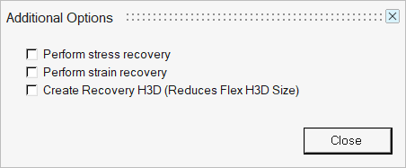

| Additional Options | Click to display the Additional Options dialog.![]() |
| Perform stress recovery | Check this option to have modal stresses computed and stored in the flex body H3D file. This option is needed to view stress for MBD simulation results in HyperView. | ||
Perform strain recovery |
Check this option to have modal strain computed and stored in the flex body H3D file. This option is needed to view strain for MBD simulation results in HyperView. | ||
| Create Recovery H3D (Reduces Flex H3D Size) | Check this option to reduce the model size by representing model as boundary
line elements (PLOTEL) and create a recovery h3d file. See Comment 7 below. |
| Perform element check in OptiStruct model | Controls whether or not OptiStruct will perform an element check of the model. | ||
| Specify units in Bulk Data File | Specify the set of units for mass, length, force,
and time that were used in the FEM file. For units to be consistent between the flexbody and the MDL model by which the flexbody is utilized, the units of the FEA model must be identified. This unit information is stored in the H3D file and all affected parameters in the solver flexbody matrix file are scaled accordingly. See the Comments section below for additional information regarding the types of units supported by FlexBodyPrep wizard. |
| The following options are applicable only for CMS type Craig-Chang Contact only: | |||
| Include contact modes around rigidified nodes: Specify interface nodes(6:8+10) |
Specify interface nodes that are connected to RBE2 elements to improve the modal characteristics of the region. Use this option to convert a rigid joint or bushings at the interface node to contact. | ||
| Include predicted contact loadset | Specify the loadset file to include pre-calculated contact prediction loadset. | ||
| Create h3d flexbody using pre-existing prp (preparation) file | Select an existing PRP file and use it to create an H3D file. | ||
| Select Pre-existing prp (preparation) file | Use the file browser to select the pre-existing PRP file that you want to use to create the H3D file. | ||
| Clear | Clear your selections and reset the wizard. | ||
| OK | After making your selections, click OK to have the wizard invoke OptiStruct and generate the flexible body H3D file. | ||
| Cancel | Exit the FlexBodyPrep wizard. | ||
