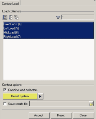

Load Collectors Options
In the Load collectors section you can select load collectors to contour. Every load collector in the current model's database displays in the load collector list.
Filter buttons allow for additional selection control, including a name filter that uses standard filtering syntax.

Contour Options
| Option | Action |
| Combine load collectors | Linearly superimposes all loads of the same load type from all selected load collectors into one simulation, named "Combined Results" within the .res file. If two load collectors are selected, and both contain force data, HyperMesh linearly superimposes their forces and plots them in one contour, as opposed to a separate force contour for each load collector. Loads are summed - or in the case of constraints, only the maximum constraint value is used. |
| Result System | Define the coordinate system in which the simulation data is
transformed into and output to the contour. If a system does not
currently exist, one can be created by clicking
Proceed without selection of a
coordinate system. If no results system is specified, HyperMesh uses the system that the loads
were created in. Note: Not available for flux or temperature
load types. |
| Save results | Store the contour results in a HyperMesh results file (.res) using a specific file directory and filename. These results can then be loaded into HyperMesh or HyperView for review. |
Command Buttons
| Option | Action |
| Accept | Opens the Contour tool, where the selection of a simulation
and a data type within that simulation are required to produce
the desired contour. The simulation corresponds to the load
collector, and the data type is the list of load types contained
within the selected load collector(s). Each simulation corresponds to one load collector. If multiple load types are contained inside a load collector, there will be multiple data types available. When using the Combine load collectors option, only one simulation will exist with the name "Combined Results" as discussed above. |
| Reset | Clear all of the entry fields on the tab so that you can start over. |
| Close | Close the tab without performing the contour plot. |

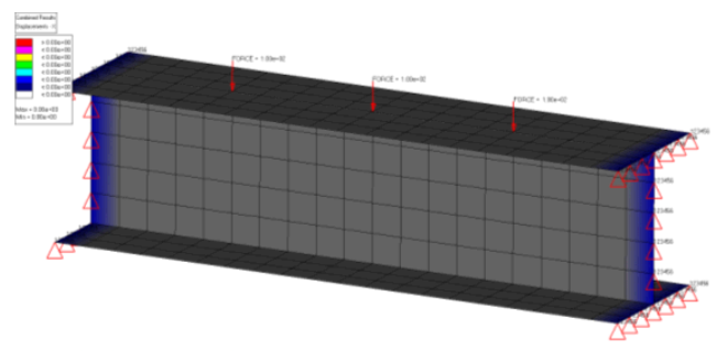

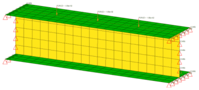

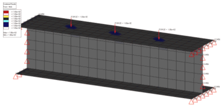

Model Contour
Example of the Contour Loads tool setup and contour for the model.
