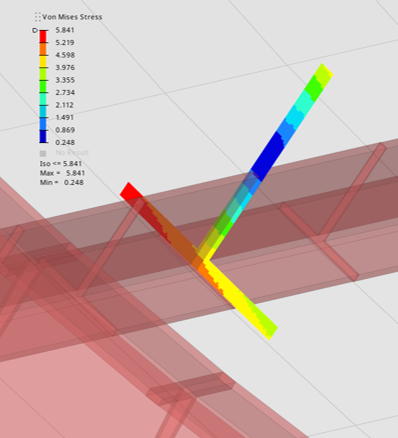

From the Post ribbon, click the Beam Stress tool.
- Select 1D elements on which to calculate stress.
Use the drop-down on the guide bar to select the stress
quantity to evaluate.
Shear Y and Z are with respect to the elemental system.

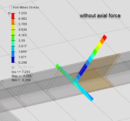

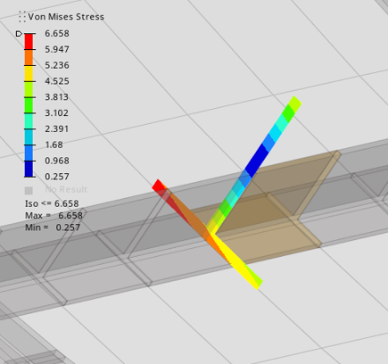

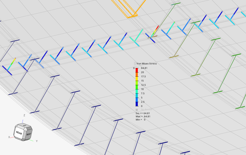

Figure 2. Von Mises Stress on Selection

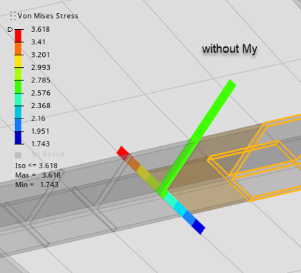

Select force and moment in the microdialog.
The selected stress quantity is calculated from the forces and moments contributions acting on first node of the beam element.

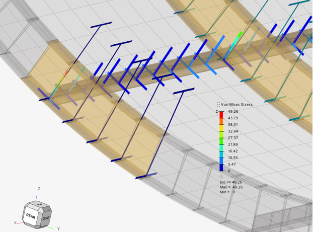

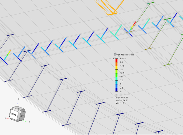

Selected beams can be contoured all at once by clicking
on
the guide bar. Otherwise, clicking
Find enters a model tour with prev/ next options to
navigate across the selection.

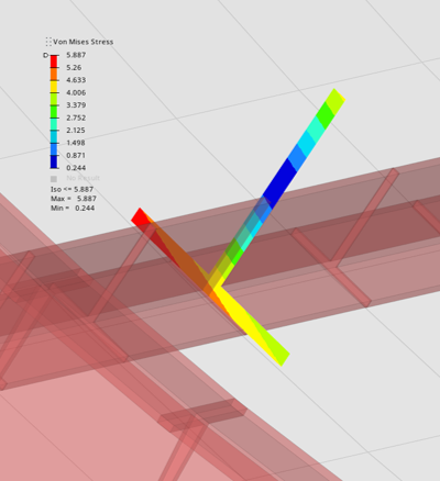

- Mesh mode
- The default stress calculation is performed using a meshed section.

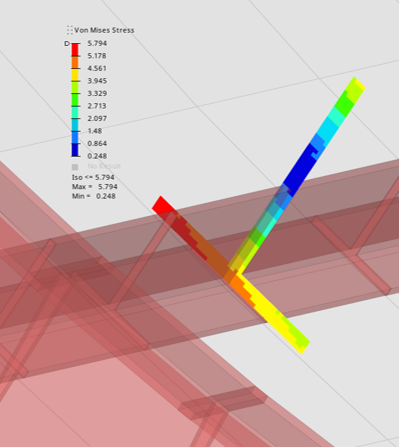

- Contour Type
- Display contour on Element (default) or on Node (see Figure 8).
