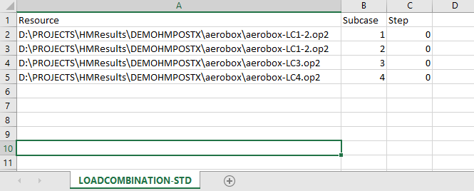

Standard Import
Use a reference to a file path and specify the subcase and
simulation (step) ID in the proper columns, as shown in the
example below.Figure 2.
Each subcase/simulation combination becomes an item/row in
the CSV file.

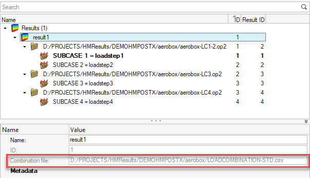

Reference to the CSV file is shown as the dataname in the
newly created result entity.Figure 3.

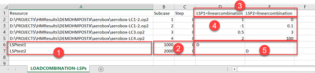

Linear Combination
Linear combination (linear superposition) can be defined in
CSV, as shown in the example below.Figure 4.
The following items are important to be understood for a
correct set up of such definition:
Add a so-called virtual resource which the newly
created load steps will belong to
Subcase and simulation step ID (which will be used
in the application)
Derived load case type (linearcombination for this
case)
Coefficients to be used for the linear
superposition
Flag “D” to identify that specific item to be
derived

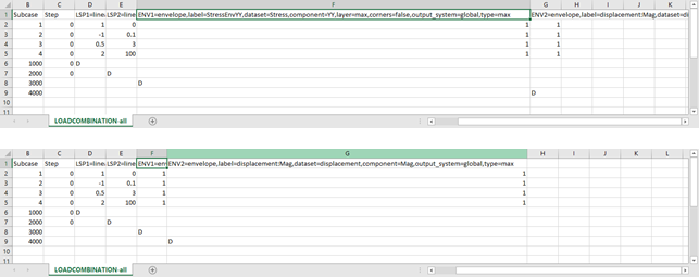

Envelope
The envelope definition follows basically the same rules of
configuration as the linear superposition, apart from the
need to set the data settings to be used as metric for the
evaluation of the envelope.Figure 5.
