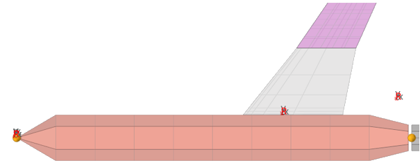

- Select point 1 (x, y, z), the origin of the panel (cylinder).
- Select point 2 (x, y, z) to define the length of the body in the local x direction (x12).
- In the microdialog, define the number of slender body elements (NSB).
- In the microdialog, define the number of interference elements (NINT).
- In the microdialog, define the length of the slender body division (LSB), if NSB is zero/undefined.
- In the microdialog, define the length of interference (LINT), if NINT is zero/undefined.
Select the aerospace coordinate system CP to define the axis of the body.
The CAERO2 ID (EID) represents the element start ID with ID spanning along the body circumference.
Figure 3.
