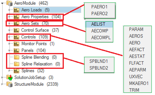

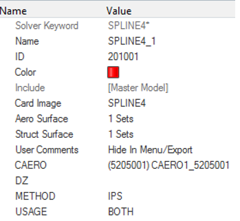

The AeroModule, SolutionJobSetup and StructureModule folders organize all of the keywords used to define the aerospace model and setup the solution job. Right-click on a folder and select Create from the context menu to begin creating cards. Use the Entity Editor to define each of the corresponding attributes for the cards.
AeroModule
The AeroModule folder organizes all of the keywords that define the aerospace model.
SolutionJobSetup
- SOL 144: Static Aeroelastic Response
- SOL 145: Aerodynamic Flutter
- SOL 146: Dynamic Aeroelastic Response
StructureModule
The StructureModule folder organizes all of the control structural entities needed for the structure definition. Using the browser you can also define or edit structural entities.
- CAERO1 panels (as special components)
- Splines (SPLINEx)
- Monitor Points (MONPNTx)
- Control Surfaces (AESURF)
- Sets and Groups (AELIST, SET1, AECOMP)
- Flight load definition, such as GUST, FLUTTER and AEFORCE
- AERO/AEROS configuration data, such as ref chord and area
- Factor table data, such as AEFACT, FLFACT, MKAEROx, UXVEC and TRIM

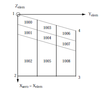

- The image icon provides more information about the numbering system and pattern to be followed while meshing CAERO1. For example, the start node and element ID should be the same as the component ID. Numbering should be sequentially incremented in the chord direction and continued in the span direction.

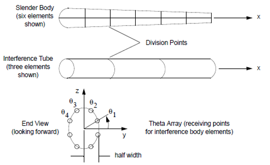

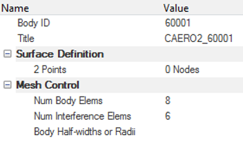

Aero Body (CAERO2)
- The Body ID and Title are defined by default. You can change these.
- Selection of two points define the axis of the body
- Mesh controls can be defined to identity number of body. Interference elements can be defined and internally required AEFACT tables will be created for the solution.
- Half width is the radius of the body at different locations. Varying cross sections can be defined by providing a comma separated half width in the Num Interference section. Missing data will be repeated with lost data entered.

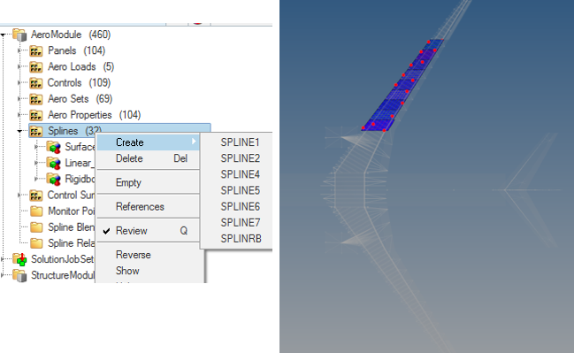

Splines

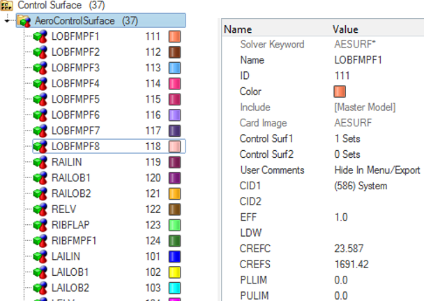

Aero Control Surface Definition

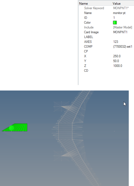

Monitor Point Definition
