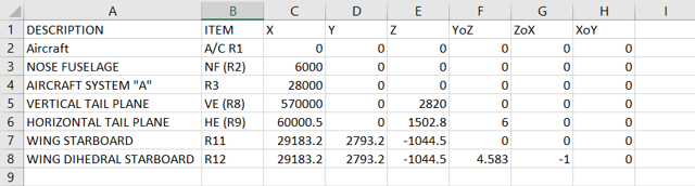

- By config file: Import a CSV, structured like the
example shown below.
Note: Once the file has been loaded, you can set up reference and destination points. - By direct input: Directly input the transformation matrix in the fields.
