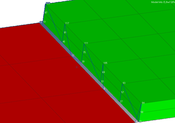

Select the Independent nodes.
Figure 1. Connecting two Dissimilar Meshes using the Nastran Displacement Constraint Element-RSpline
Select the Dependent nodes and their degrees of
freedom.
A new component is created, and the RSpline elements are added to the component.

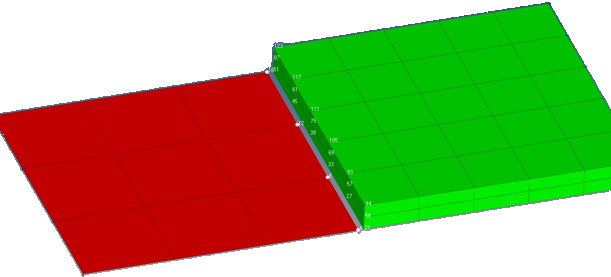

Click the Edit tab to correct the sequence or review it.
Figure 2. Dissimilar Meshes are Connected with RSpline Element
