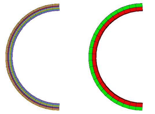

In the Solid Elems field, select an option that controls the number of solid
elements generated through thickness.
- Create solids for each layer – generate single solid elements for each input ply layer.
- Create single solids for all layers – generate single layered solid element through thickness. Output is either continuum shell of layered solid depending on the solver profile, element type setting (can be changed from panel under penta6 and hexa8) and template property.

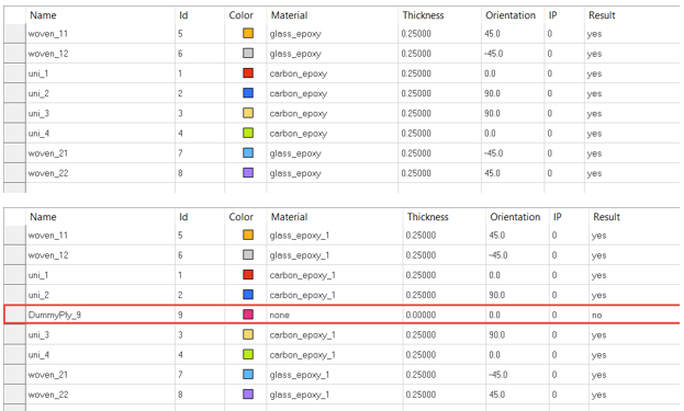

- Create multiple solids using dummy ply separation – generate multiple layered solid elements through thickness. The number of layered solid elements is determined by the number of “Dummy Plies” in the laminate. Output is either continuum shell or layered solid depending on the solver profile, element type setting (can be changed from panel under penta6 and hexa8) and template property.

Figure 2. Dummy Ply for Create Multiple Solids Using Dummy Ply Separation
